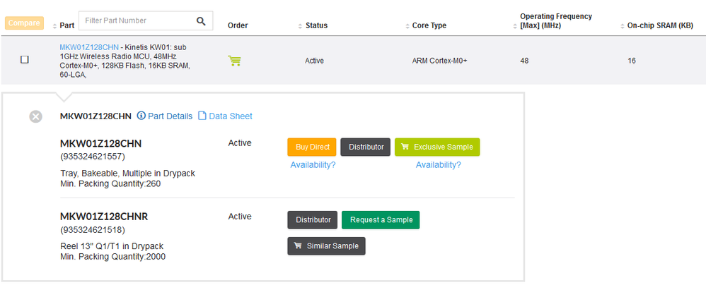

Thanks if you hepls what RF receiver i can use RFM69HW or CC1101 OR MKW01 I suppose that i can use MKW01 but i dont know where i can buy that.

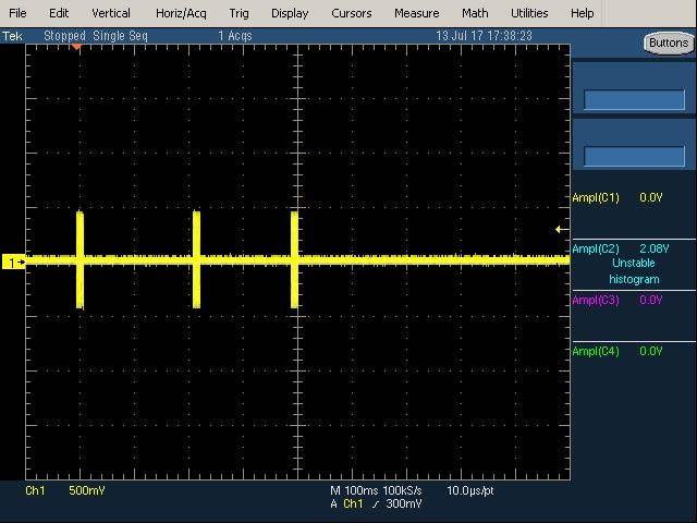

Is your probe directly on the antenna? It should be directly on the antenna instead of the RF pin. Once it is in the antenna be careful, the voltage is very low. On my oscilloscope screenshot the unit is 500mV/unit so you should increase your resolution to have around 500mV/ unit for vertical and 10 or 100ms per unit for horizontal and depending on how the matching network is done, you may need to go to 50mV/unit for vertical resolution

In order to probe that the module transmit you can place an oscilloscope probe on the RF antenna to watch the frames. It should not show you Vcc,  you should be able to see something like this
You can use an sniffer that is listening to make sure the module is transmitting

I would recommend using the MKW01 instead, we have a very detailed guide: Using the Kinetis KW01 as the Receiver for the FXTH870 TPMS Sensor, that explains how to properly configure both (receiver and transmitter) to make a successful communication, maybe you could use that document as a reference.
You can buy the part directly from our web page, the part number is MKW01Z128CHN, we also have the MRB-KW01 which is the evaluation board of this part.
Click the part number and then buy direct.
