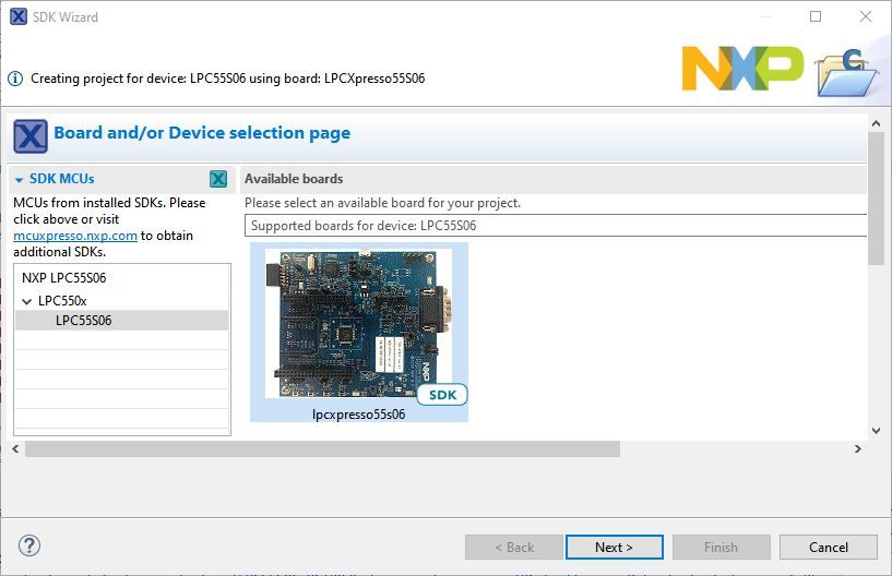

I created a new project in MCUXpresso IDE v11.3.0 based on SDK_2.8.2_LPCXpresso55S06 using the New project wizard:

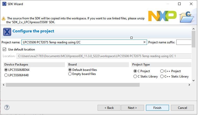

It was not necessary to make any changes to the project and I named it LPC55S06 PCT2075 Temp reading using I2C in the wizard:

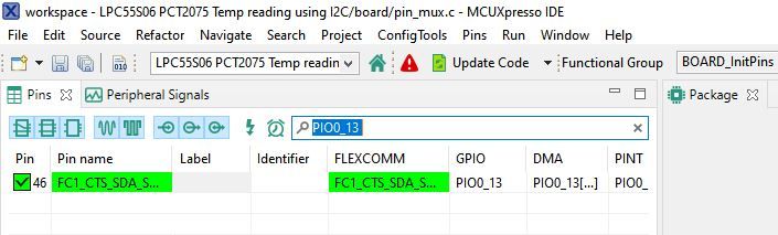

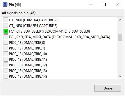

...to configure PIO0_13 and PIO0_14 for their I2C functions (I2C_SDA and I2C_SCL, respectively). Simply search for each pad in the Pins view:
In the diagram above, I already have PIO0_13 routed for I2C function (it is showing green). However, you may want to check the checkbox in the first column to mark the pin for routing. A dialog pops up, offering you all the possible pin multiplex functions for the pad. Scroll down through the list and select FlexComm1’s SDA function:

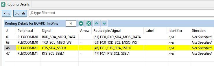

When you put a checkmark (“tick”) in the FC1_CTS_SDA row, the Pins Config tool routes the pad and you will see a new entry (in yellow) in the Routed Details view at the bottom of the perspective:
Follow the same procedure to route PIO0_14 for function FC1_SCL. That is already done in the screen-grab above, so I am ready to move to the Peripherals Config tool.

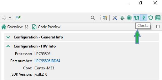

Use the Peripherals icon to switch to the Peripherals perspective:

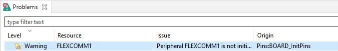

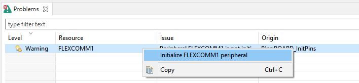

The Peripherals Config tool identifies that I have set up the pads/pins for FlexComm1 to be used as I2C. But I have not yet set up the I2C peripheral, and so the tool reports a Warning:
There is a very simple fix, proposed by the tool. Select the FLEXCOMM1 warning line, and right-click to bring up a context menu:

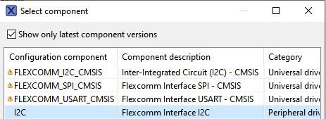

Selecting “Initialize FLEXCOMM1 peripheral” opens a dialog where I can select the desired function for FlexComm1… in this case I want I2C configuration. So I select I2C and click [OK]:

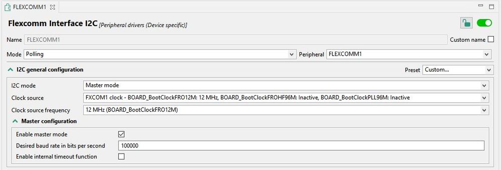

The Peripherals Config tool displays the Flexcomm Interface I2C configuration screen. This shows all of the ‘top level’ settings for the I2C module. I configured it as follows:

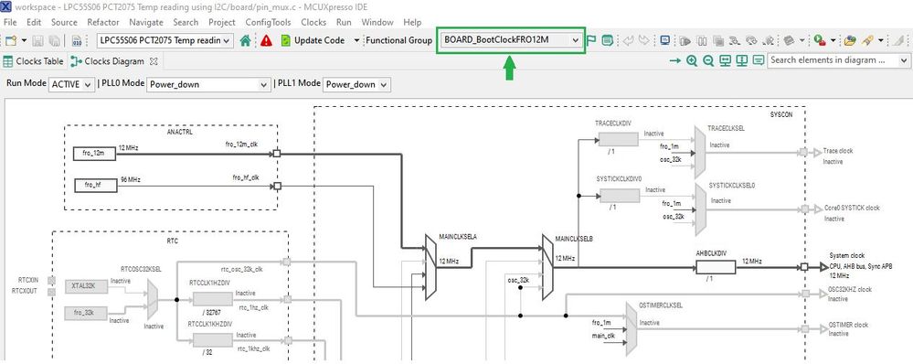

I am ready to move to the final, Clocks Config tool:
I chose to use the BOARD_BootClockFRO12M() functional group:

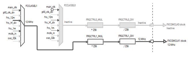

Then I enabled the clock to FlexComm1, since this is the FlexComm module that I use for I2C. I used the fro_12m as the clock source for FlexComm1 I2C:

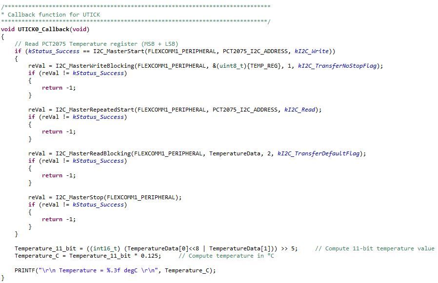

In the UTICK0_Callback function, the Temp register is read and then the real temperature in °C is calculated as shown below. For more information on how to convert the raw values from the Temp register to real values in °C, please refer to the PCT2075 data sheet (Chapter 7.4.3).
This screenshot shows the two bytes read of the Temp register (0x00).

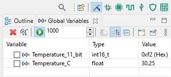

The calculated temperature can be watched either in the "Global Variables" window on the top right of the Debug perspective...:

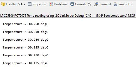

...or in the Console window:
