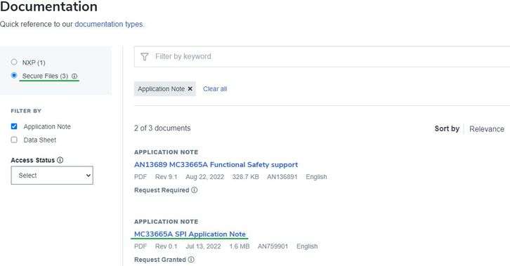

And you might find useful the AN13640 "MC33665A SPI Application note" which is available as a Secure file (NDA required):
https://www.nxp.com/products/power-management/battery-management/battery-communication-ics/general-p...
