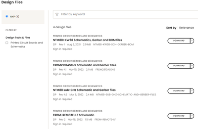

Hello everybody! I thank the help of all! I'm about to receive the NTM88 development kit, I noticed that the chip used in reception is the NCK2910, and in the documents I found, it has pins for communicating with Arduino, has NXP developed any specific documentation about this communication? Example codes, libraries for Arduino or something like that? From now on, cat!

Hello Israel,
regarding the part number, the NCK2910AHN is the correct full part number, the numbers after the slash define marketing statuses. E.g. in what packing it is delivered, minimum quantity order etc. I am no able decode it, but the /10203Y doesn't define any technical parameters of the component.
Regarding the EVBs. The NCK2910AHN is populated only on the FRDM2910ASEN, on the other EVBs, the NCK2910AHN is not used. Please refer to the design files in the NTM88 product page.

Thanks for the quick response! Can you tell me if the "NCK2910AHN/10203Y" chip is the same or equivalent that comes on the development board?

Hello Israel,
unfortunately no. We do not have software for Arduino. The board has only the dimensions compatible with Arduino boards. Many of our MCU boards have the size compatible with Arduino boards. E.g. FRDM-KL25Z or FRDM-KL43Z and many others.
For the software to please refer to this link: https://www.nxp.com/search?keyword=NCK2910&start=0
