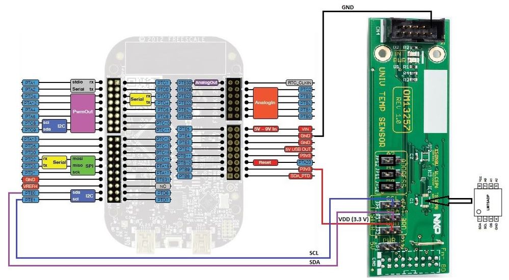

NXP offers the OM13257 temperature sensor daughter card for easy evaluation of most NXP’s temperature sensors including the LM75ADP in a small 8-pin TSSOP8 package. The daughter card is shipped with no temperature sensors soldered to the board, so the LM75ADP needs to be purchased and soldered separately. The daughter board is designed to connect directly to the OM13320 Fm+ Development kit, but I have decided to pair it with one of the most popular Freedom development boards – FRDM-KL25Z.
The wiring is very straightforward as shown on the picture below. Both SCL (JP4-2) and SDA (JP3-2) lines are connected through the on-board 10K pull-up resistors to the I2C1 module (PTE1 and PTE0 pins) on the KL25Z128 MCU. The Vcc pin (JP2-2) is connected to the 3.3V supply voltage and the GND pin to common ground. The address select pins A2, A1 and A0 are connected to GND using jumpers between pins 1 and 2 of JP12, JP11 and JP10, resulting in a 7-bit I2C slave address of 0x48.

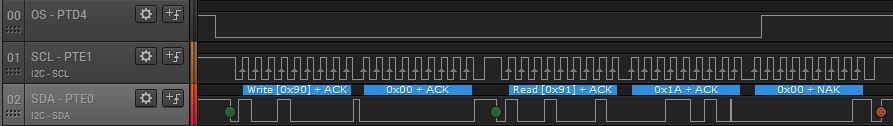

The screenshot below shows the two bytes read of the Temp register. It also illustrates how the OS output is activated in interrupt mode by crossing the Tos threshold value stored in the Tos register. The threshold value was set to 26°C, which corresponds to 16-bit value of 0x1A00 read out of the Temp register.

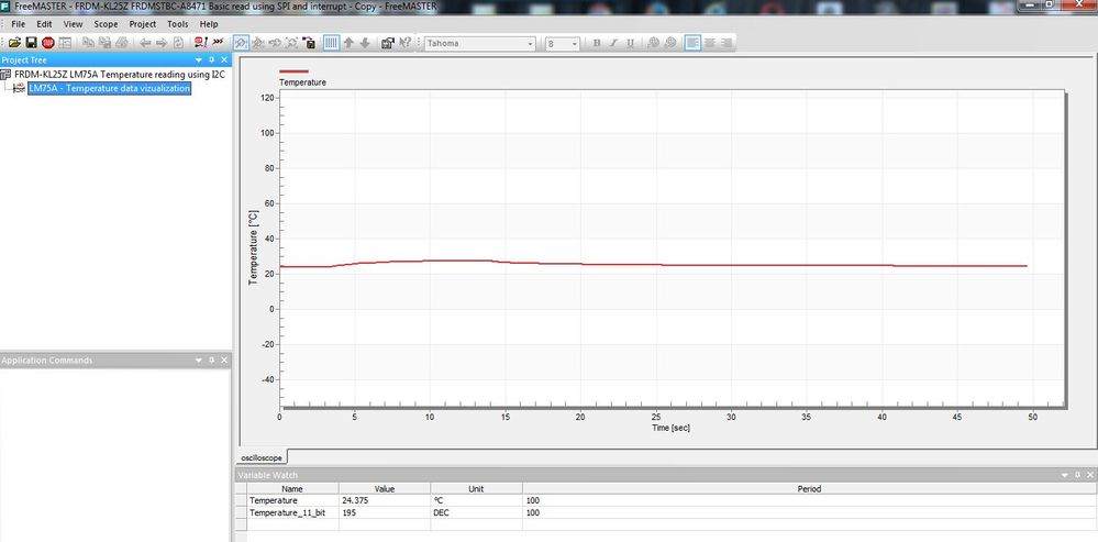

The calculated temperature can be watched in the "Variables" window on the top right of the Debug perspective or in the FreeMASTER application. To open and run the FreeMASTER project, install the FreeMASTER 2.0 application and FreeMASTER Communication Driver. You can try touching your finger to the sensor to see the temperature rise.
