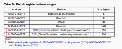

Hi Dear:
In the timer address description of MM9Z1 638,0ffset related to 0x0E00 for blocking access and 0x0F00
for non blocking access within the global address space.According to the manual, it is determined by
blocking access window and non-blocking write window of D2Dl, but I can't find the method and identifier
about how to be in the above window in D2Dl, so I can't determine the timer l want to write.

using the CodeWarrior IDE, provides a device description file mm9z1j638.h containing all registers address information.
For D2D registers (registers located on the analog die and which are accessed via the D2D interface) two symbols for blocking and none-blocking access are provided, e.g. B_TCNT and NB_TCNT.
Example:
B_TCNT = 0x0000; // reset counter value
It's strongly recommended to use blocking access!

Thank you for your answers
