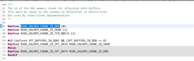

The error seems clear: "Failed to allocate 0x180040 bytes from chunk 1"
Maybe the CHUNK IDs are not obvious? That I agree. Those can be found in the app
app_mem_mgr.h
Peter

petervlna
CHUNK 1 is SRAM.
S32R45 has 8MB of SRAM.

sinetech
hello Peter,
I already know the define of CHUNK ID in app_mem_mgr.h. But I face this error often, even though the request size is 512K that less than 8M SRAM size.

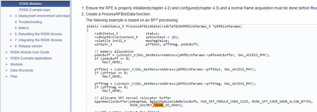

petervlna
Without knowing what app are you running ( if it is RSDK or custom) and what RSDK is used, the only assumption I can make is that memory is allocated in SRAM but not properly deallocated so after a few iterations, the error occurs because there is no more available space in that chunk
 As for documentation, apart from what is in the user manual, the source code is available for OAL. Other than that I'm not aware of other, more detailed documentation.
