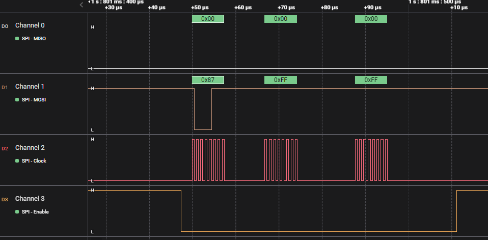

Please see attached schematic. utilizing PCF2131. VDD is set to 3.30V, confirmed with measurements. BBS pin is floating. VBAT was tested set to both 0V (no backup cell) and 3.20V (backup cell in holder).
At startup, register 0x07 and 0x08 are read (sec and min reigsters). They worked initially when I had not tried to write to any register. I tried to write 0x20 to register 0x02 and ever since I did that, the RTC stopped responding with anything other than 0 for any register read. I tried this on two units I have and both are now non-responsive. I can try to write other values if you can advise anything that may recover the RTC.

TomasVaverka
Hello Jigney,
Could you try to remove the coin cell battery and force VBAT to GND?
Then, without installing the coin cell again, power up the part (without VBAT) and try the same register write (0x20 to register 02h). Does it still fail after this write?
Tomas

ctmaker
and @TomasVaverka , please see attached SPI trace as well, where I am trying to read register 0x07. One would think that if I disconnect from all power, the IC should reset to defaults, but it is puzzling that once I write, I am unable to read, ever. Don't know if there is something else that I may be missing.
