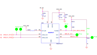

Hi NXP Team,
We're using the NXP20P0477 IC on our board, and we're encountering an issue with its abnormal behavior. Even when no fault is present, it sometimes incorrectly shows a fault, and the FLAG signal goes low. At Controller end we are not using CC2 IC it is NM
Please check the below Moisture IC schematic FYR

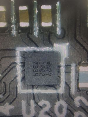

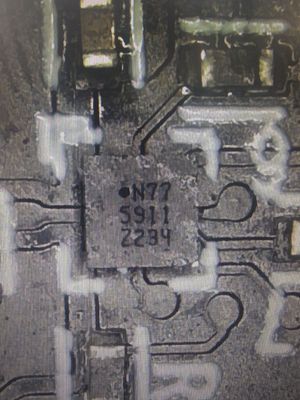

JyotiVaishnav
Hell Tomas,
One more query i need to address here , the marking on the IC which we are using in our current project is N7710022934 ,and the marking on the ic which we used in our previous project (were Ic is working properly , no false moisture detection)is N775911z234.
Why there is different marking in the IC ?, we have used same part no .
Please help us to answer this query , i just want to cross check whether there is no issue in the IC itself .

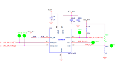

JyotiVaishnav
Hi Tomas,
The 1kΩ pull-down resistor is specified on the CC2 line. Do you have any recommendations for the pull-down resistor value? Please share your input if there are any suggested values. Also, please see the image below. Meanwhile will check after changing the IC

TomasVaverka
Hi Joyti,
The only feedback I have received so far from our product/test group is that "N775911z234" corresponds to WW34 of 2019 and "N7710022934" to WW34 of 2022. I am still waiting to hear if there are any functional differences between them or if there is any known issue with this newer batch (N7710022934).

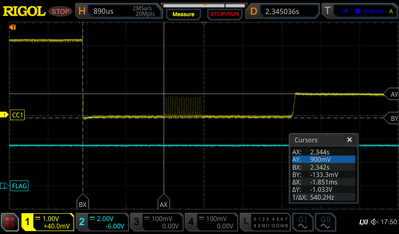

TomasVaverka
Hi Jyoti,
FLAGB is an open-drain output and your schematic correctly uses a 100kOhm pull-up to 3.3V. It goes low when the device enters Moisture.DET state (COMP2 = high and COMP3 = low).
CP_EN is pulled-up to 3.3V via a 4.7kOhm resistor which enables the moisture detection logic.
Any noise or improper line status on CON_CCx can cause transitions into Moisture.DET state, especially during attach/detach events. So check for connector or routing noise that might mimic moisture. Also consider logging or probing CON_CC1/CC2 and CC1/CC2 voltages during failure.

JyotiVaishnav
Hi Tomas,
Please find the below waveform - measured on CC1 (IC input TP148)and FLAG (TP154 flag pin) in charging condition
below waveform - measured on CC1 (IC input TP148)and FLAG (TP154 flag pin) in moisture fault condition
Observation: As seen in the image above, a 350mV drift was observed on the CC line under fault conditions, and a moisture fault occurred after 4.3ms.
Please provide your suggestion to debug the issue
