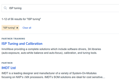

After downloading and compiling the BSP (L5.10.352.0.0) environment of YOCTO, I also downloaded and compiled linux-imx,isp-imx and isp-vcam respectively, and copied the required files into a folder to imx8mplus according to the requirements. But after I run./isp_media_server Camera0&after following the last step in the manual, I run Tuning-Client.exe program on my win10 computer for connection (I want to online ISP Tuning), this client is not connected,
Do I need any more steps to connect?
Can you help me with this problem? Thank you very much!

where did you get Tuning-Client.exe?

my current problem is the isp_media_server on my imx8mp board cannot be started.
I have copied the necessary files to the imx8mp board 。
2,686 次查看
LDX
I downloaded it on NXP's official website
The package name is Release of ISP tools for i.MX 8Mplus based on 6.1.22 BSP release.
Tuning-Client.exe is inside。
2,622 次查看
joanxie
pls share the download page, let me double check it, I didn't find this tools when I search ISP Tuning or ISP tuning tools, do you have ISP Tuning guide
