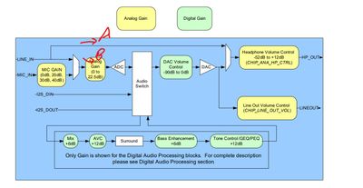

I am running Android 11 operating system with IMX8MQ processor on custom carrier board. I am using SGTL5000 codec.
I am trying to record sound by connecting microphone to Line-In pin of SGTL5000 chip. However, Frame number is different from 0, that is, although frame size increases as recording time increases, no sound is heard in xxx.wav file that is recorded.
I am sure about microphone connection because same connection works with same sgtl5000 codec in our other Linux based custom devices.
In my researches, I see that some people have this problem but they measure 0 frames after recording. I do not have such a situation, I see that frame size increases as recording time increases.
As stated in SGTL5000 document, Line-In can bypass ADC and go to Headphone output. In order to cancel this, I cleared CHIP_ANA_CTRL -> SELECT_HP bit. I write the value 0x0036 to the CHIP_ANA_CTRL register on the driver side. Therefore, I think Line-In does not go directly to the HP output, it goes to the adc.
Also, I learned that the ADC_POWERUP Bit value in the CHIP_DIG_POWER register specified in the datasheet should be 0x1 for the adc to be enabled, when I check the driver side, the ADC_POWERUP and DAC_POWERUP bit values ​​appear as 0x1. So there is no problem there either.
I use tinycap for sound recording.
I open sound files with tinyplay. I get sound through the lineout pins. I can listen to normal wav files, only the file I record has no sound.
I noticed that there is a capture mux variable in the tinymix settings. Even though I changed this to LINE_IN, I still cannot record sound properly.

Hello everyone. I have solved the problem. Problem was in sai2 definition of devicetree. MX8MQ_IOMUXC_SAI2_RXD0_SAI2_RX_DATA0  was not defined which is responsible for audio input functionality of I2S.
Here is old version and new worked version of sai2grp definition.

Worked version of sai2 definition
      pinctrl_sai2: sai2grp {
                fsl,pins = <
                        MX8MQ_IOMUXC_SAI2_TXFS_SAI2_TX_SYNC     0xd6
                        MX8MQ_IOMUXC_SAI2_TXC_SAI2_TX_BCLK      0xd6
                        MX8MQ_IOMUXC_SAI2_MCLK_SAI2_MCLK        0xd6
                        MX8MQ_IOMUXC_SAI2_TXD0_SAI2_TX_DATA0    0xd6
           MX8MQ_IOMUXC_SAI2_RXD0_SAI2_RX_DATA0    0xd6
Thank you for following this topic.

As far as ı know, line in goes directly headphone output or goes internal audio switch. So, ı have checked the driver to see what is default and it was going to headphone directly. I have changed it by looking at datasheet. It is 6th bit of CHIP_ANA_CTRL 0x0024 register. I have cleared it since datasheet was telling it to use line-in as input of audio switch. I have attached the figure for this. Long story short I have changed the direction from A to B by writing 0x0036 value to  0x0024 CHIP_ANA_CTRL register so it enabled line-in as adc input, unmute adc analog volume and select headphone input as DAC.
So ı think driver side is okay, ı have seen changed kernel driver messages in kernel(check dmesg you can see a info line of sgtl5000 content topkarag). Maybe there should be something missing with configuration except from driver ? Do you know anything else for configuration routing except audio_policy_configuration.xml file ? Which files or configurations effect this issue ? Specially android11 and linux kernel 5.10 ? As far as ı know there is only audio_policy_configuration file.
