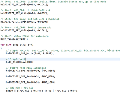

         I have been working with current measurement diagnostic in MC33772B as follows:
I  set I_MUX = 10b and Gain = 4 to diagnostic measurement chain with known VREF_DIAG reference.  MEAS_ISENSE1 | MEAS_ISENSE2  after wait for 0.86ms (SOC to conversion complete) is about [-13,18]uV, out of range [123.5, 129.5]mV. Is there any wrong?
source code as below:
Looking forward to your reply.
