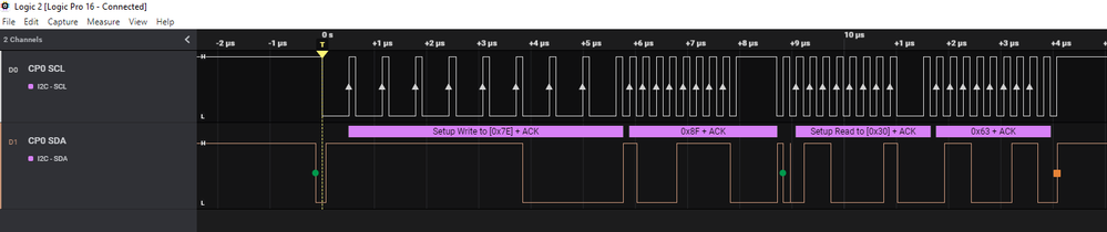

When I attempt the command GETDCR,  it returns to me the wrong value and it does not set the "T" bit low to signal the end of the transaction.   According to the Table 8 of datasheet, the value returned should be 0x63 to represent a temperature sensor.  Instead the value returned is 0x17, 0x18 or 0x19 depending on the ambient temperature.  It seems like it is returning the first byte of the temperature register.

Below is a logic analyzer capture of the Direct Read operation for GETDCR.   The Logic Analyzer understands and decodes 0x8F as GETDCR.    Using the same HW and Software methods, I can read the BCR and get the correct return byte of 0x3.   In both cases, I first run a SETDASA command to set the dynamic address of the sensor before running the Direct Read command.

I got this to work correctly.   The issue was a runt pulse being generated by the FPGA that is the I3C controller.    Once the contractor changed the FPGA code, then it started to readback 0x63.   While the problem was in the FPGA, it should be noted that the only DCR gave back bad data.   Other command worked correctly and GETDCR did not fail, it just jumped to the wrong portion of the P3T1755.

Hi Stephen,
Please see below and attached waveform for GETDCR command, it reads 0x63 DCR value from PT31755. NXP RT-685 MCU board was used as an I3C master controller, what I3C master controller are you using?

Our I3C controller is FPGA based.   We need multiple controllers in a test application and the FPGA already existed in the project.    The FPGA is not my design and I presently do not have the source code.   My task is to get the C++ code interface working.    I changed the dynamic address of 0x30 to match your example.   I will attach a screen shot, the results are the same.   However, as I noted GETBCR and GETPID both return the correct data.   GETPID returns:
