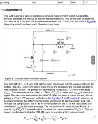

Hi Nxp partner
We would like to know how to control iso_Q1,iso_QL1 and iso_QL2 on  the RD772BJBTPLEVB for insulation resistance circuit. What is those switch control signal turn on time at each step. Could you give the evm firmware code for reference ?

You will find the EVM firmware here: Automotive Software Package Manager
Please go to S32K344 and then HVBMS.
Hope this helps.
