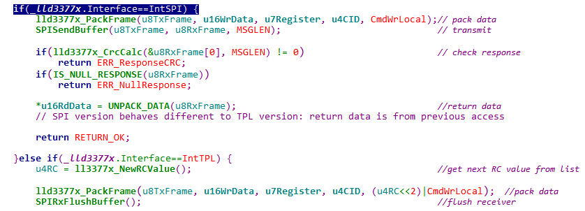

hello, i am using MC33664 combined with MC33771 to design a battery management system too , my MCU comunicate with MC33664 which is a high votalge isolation chip in spi mode,but MC33664 communicate with MC33771 in TPL mode,I looked into the driver code and wonder  which interface type i should choose, could you help me with this problem ?thank you very much!
4,240件の閲覧回数
TomasVaverka
Hi Huang,
In such a case, you should select the TPL mode (IntTPL).
Tomas

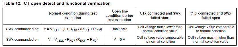

   Thank you very much, you had helped me solve this problem perfectly. And I run into another problem again, in my code , Compare odd cell terminal pre-switch closure results to post switch closure results to determine fault mode according to datasheet <5.9 Table12: CT Open Detect and Functional Verification>.
as follow:
In my understanding , "Open line condition during test execution " means the same with"SWx failed open" .
But ,if so, then why when SWx command close ,  under Open line condition :V=0, but under SWx failed open condition:
Cell voltage much higher? I am confused by the question, could you please help me with it? Much appreciated!
