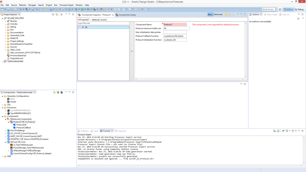

The problem is that I can't build a project on Kinetis Design Studio using ISF Components. See, when I try to use a ISFCOre, it automatically add a ISF_CI_Protocol Component, and that adds an error. It seems that the selected processor (I'm using the K64F board) does not support CI procotol (see the image).
The project builds only if I remove this Component, and that, I think, is the cause to receive a device error when I send command to start the data streaming.
I've tried several configurations for the protocol, but it does not work.
It's curious that all the demos (compiled firmwares) run exactly as expected, but if I download a sample project (ISF_K64F_KDS_PROJ for instance) and build it and run it, I get the start streaming error during communication.

michaelestanley
Bruno,
I've got a couple, and if those don't work for you, I'll pull in some of our ISF experts to help sort things.  My projects are Codwarrior-based.  It's possible that there might be some differences between the two platforms.  I can tell you for a fact that ISF (including the command interface) should work just fine with the K64F, as it is a board I use for a lot of my own projects.
  1. I see TWO CPU instances listed under your P.E. "Processors" heading.  There should only be one.
  2. I think that for the K64F, you should be using MK64FN1M0VLL12 (at least that is the one I use in my CodeWarrior projects).  Your screen lists the MK64FNM0VLQ12.  ISF should work out of the box for the VLL12.  It will require more work to work for other variants.  It CAN be done, but I'll need to pull in people with more expertise than me to help if you go that route.
So try deleting the 2 CPUs you have and replacing them with the MK64FN1M0VLL12.  Then let us know the result.  Please note that today is a holiday for for the US-based ISF team, so further feedback may have to wait until Monday.

brunogodoieilli
Hello Michael.
I've noticed all those points earlier, but even making the appropriate changes, still makes no difference. :smileysad:
I also noticed that the template project, for ISF, brings the wrong processor, MK64FNM0VLQ12, and duplicate it.
Could the problem be the ISF R2P1 PEx.PEupd file? Is it possible to get the project to build the .PEupd file?

brunogodoieilli
Wrong image above, here is the right one:
