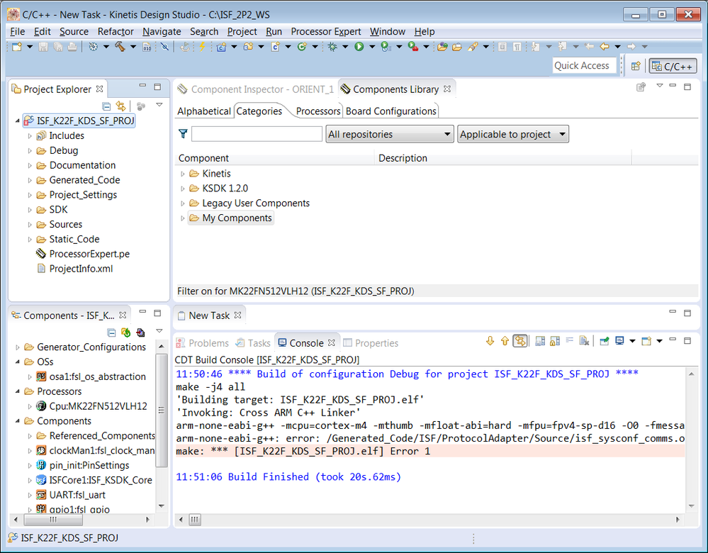

Hi, I get the following error message when building ISF_K22F_KDS_SF_PROJ:
arm-none-eabi-g++: error: /Generated_Code/ISF/ProtocolAdapter/Source/isf_sysconf_comms.o: No such file or directory
I think I have all the right updates. I ran the ISF R2.2 Installer and also installed the ISF2P2_PEx.PEupd to PEx.
Using KDS 3.1 and KSDK 1.2.0. When I do a Help>Check for updates I get a "No Updates Were Founds".
(The exported project archive file but it was too big to attach.)

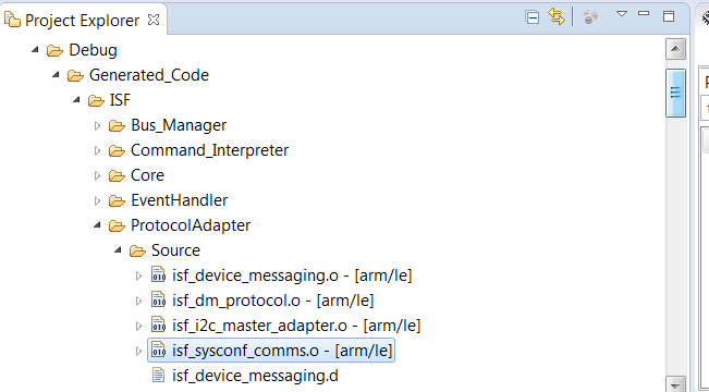

I do see isf_sysconf_comms.o in the Project Explorer (and in Windoows Explorer) so it is there.
Any thoughts on what I am doing wrong?
Mark

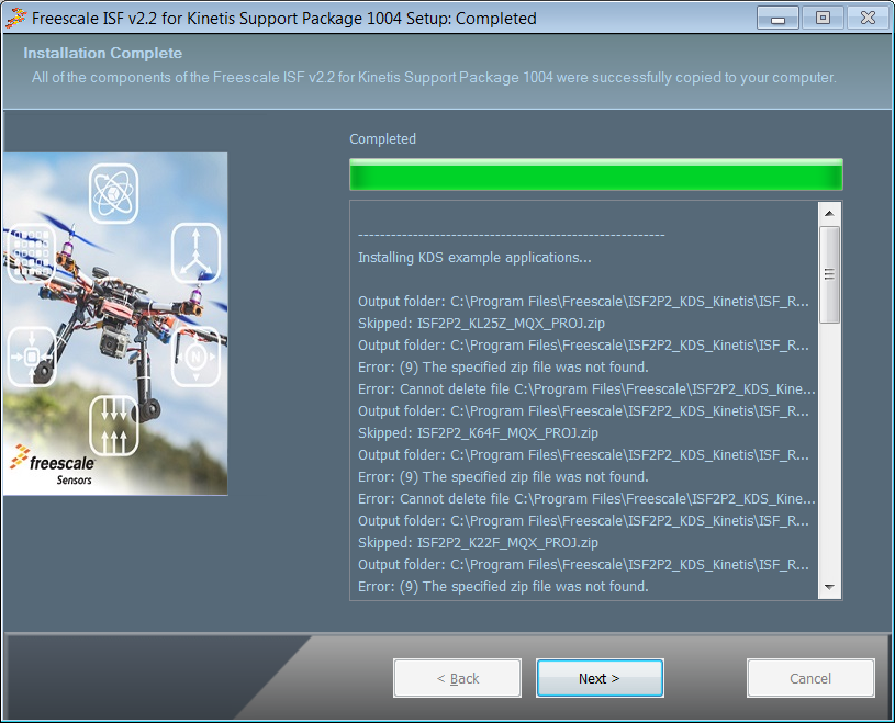

Ah Ha! I did not have that path or those files.
I re-tried ISF2P2_Installer.exe and noticed that I am getting some errors (below).
I re-ran ISF2P2_Installer.exe "as administrator" and I now have those example projects!
Thank you Dave!

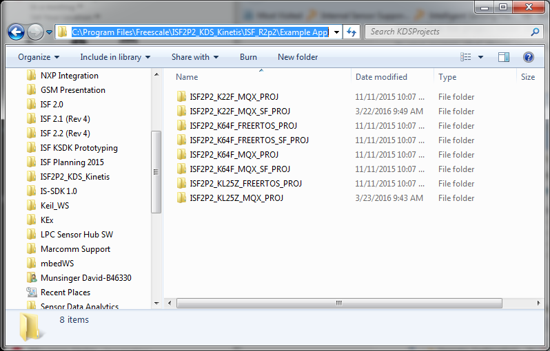

Hi Mark,
This is your problem, I'm about 90% sure.
Try navigating (inside KDS 3.x Import Existing Project) to here:
Try the project from this location and I bet it will work.
Dave...

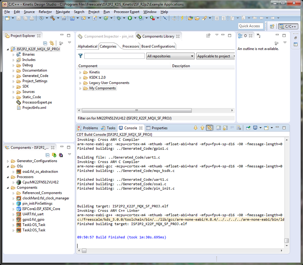

Hi Mark,
I think you may have leftover projects from previous versions of ISF 2.2.  We have just released a new ISF 2.2 Installer (3/4/2016), so please check that.  I did the install fresh this morning.  The corresponding project (build) should look like this:
Please check the installation and make sure you are importing ISF2P2_K22F_MQX_SF_PROJ.

marks
Hi Dave,
I think you are on to something with your suggestion about "make sure you are importing ISF2P2_K22F_MQX_SF_PROJ".
Is it possible the older file is posted the on web?
On 3/21/2016 I downloaded a file called ISF2P2_K22F_MQX_SF_PROJ.zip.  I created a work space called ISF_2P2_WS and put the .zip file in there and un-zipped the file.
Notice that the project folder starts off with ISF_K22F... not ISF2P2_K22F...
In your screen shot above your project name starts with ISF2P2_K22F.... My project starts with ISF_K22F... Screen shot below.
Why the difference between my project name and yours?
Please download ISF2P2_K22F_MQX_SF_PROJ.zip off the NXP public web site and you'll see what I mean.
Mark
