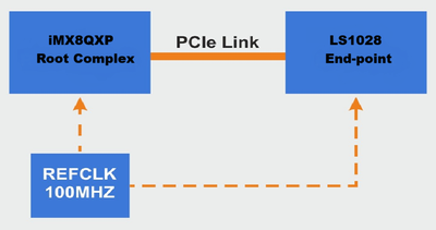

System Overview
As depicted in the illustration above, the system has 2 main blocks: -
a. iMX8QXP [configured as PCIe Root Complex]
b. LS1028 [ configured as PCIe Endpoint]
Software components: -
iMX8QXP - Linux Factory 6.6.36
LS1028ARDB - LSDK-18.09
Hardware components: -
iMX8QXP MEK Board
LS1028ARDB Board

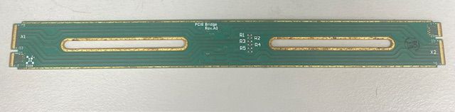

M.2 Key E PCIe Bridge
The root complex and endpoint are connected via a PCIe bridge on M.2 Key E connector of both the boards.
Reference clock used for both PCIe RC and EP - 100 MHz
PCIe Bridge with M.2 Key E interfacePCIe Bridge with M.2 Key E interface

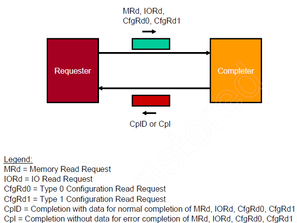

What are Outbound and Inbound transactions in PCIe?
To explain the concept of outbound and inbound transactions, there are 2 entities that we need to keep in mind w.r.t the transactions that flow in the PCIe fabric:-
Initiator - component that initiates the transaction by sending a request. Example- Memory Read request sends the request for data.
Completer -  component that receives the request and eventually sends a response. Example - After receiving Memory Read request sent by the initiator to it, it sends the completion TLP containing the requested data back to the initiator.
Transactions in PCIe can be categorized into 2 parts, depending on the direction of data flow relative to a device [Root complex or End-point]  :-
Inbound - Data is coming into the device from the PCIe bus. From the device's perspective, the device is the completer of this request which was initiated by some other device. Example - Root complex[initiator] sending memory write TLP to an End-point[completer]. In this case EP will have inbound transactions coming from RC.
Outbound - Data is going out from the device to the PCIe bus. From the device's perspective, the device is the initiator of this request which will be completed by some other device. Example - End-point[Initiator] sending memory read TLP to a Root-complex[completer]. In this case, EP will have outbound transactions going towards RC.

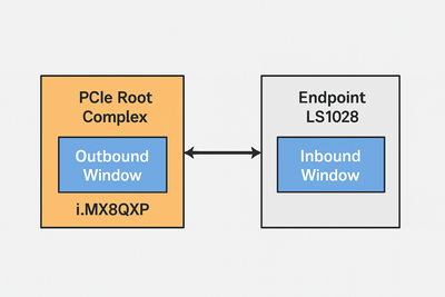

How to configure PCIe Outbound and Inbound windows in iMX8QXP & LS1028 respectively?
For our use-case, we will be configuring 1 outbound window on iMX8QXP [Root Complex] and 1 Inbound window on LS1028A[Endpoint].
a. To set up an Outbound window on iMX8QXP, we configure the following registers:-
iATU Index register
- defines which region is being accessed and its direction[Inbound/Outbound].
iATU Region Control 1 Register - To control some programmable bit fields
iATU Lower Base Address Register
iATU Upper Base Address Register
- These registers configure the start address of a window before the translation
iATU Limit Address Register - To configure the End-address of the window before the translation
iATU Lower Target Address Register
iATU Upper Target Address Register
- These registers configure the start and end addresses after the translation.
iATU Region Control 2 Register - To enable the REGION_EN bit and select match mode.
Outbound WindowOutbound Window
b. To set up an Inbound window on LS1028A, we configure the same set of registers :-
iATU Index Register
Additionally, we will be configuring
PCI Express Command Register - to enable Bus master bit
PEX PF0 CONFIG Register - to set the Config Ready bit. Used by EP to indicate the RC that the controller has done its initialization.
The reason why we need to configure 2 additional registers on the EP side is that LS1028[EP] will be at Uboot console the whole time we are exercising our use-case. If it was in Linux, the PCIe drivers would have taken care of this.
Inbound WindowInbound Window
