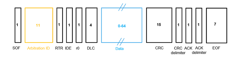

A CAN frame contains the following parts:
  • Start of Frame (SOF) bit – Sends a dominant ‘0’ to tell other ECUs that a message is coming
  • Arbitration ID – Identifies the message as well as the priority. A standard CAN (CAN 2.0A) frame has an 11-bit ID while an extended CAN (CAN 2.0B) frame has a 29-bit ID.
  • Remote Transmission Request (RTR) bit – Allows the ECU to request messages from other ECUs by sending a recessive ‘1’ bit. RTR is a dominant ‘0’ bit in the case of a data file.
  • IDE – Indicates whether this is a base format frame (11-bit identifier) or extended format frame (29-bit identifier).
  • r0 – Reserved bit, more recently known as Flexible Data Format (FDF) bit. Indicates whether the frame is Classic CAN or CAN FD.
  • Data Length Code (DLC) – Contains the length of the data in bytes (0-8 bytes)
  • Data – Contains the actual data values; length is dictated by DLC field.
  • Cyclic Redundancy Check (CRC) – Error-detecting code that checks the data integrity.
  • CRC delimiter bit – Must be a recessive ‘1’.
  • Acknowledgement slot (ACK): Confirms that the CRC process is OK.
  • ACK delimiter bit – Must be a recessive ‘1’.
  • End of Frame (EOF): 7 bits; end of frame is indicated with a recessive ‘1.’
Standard CAN frameStandard CAN frame
Figure 2: Standard CAN frame

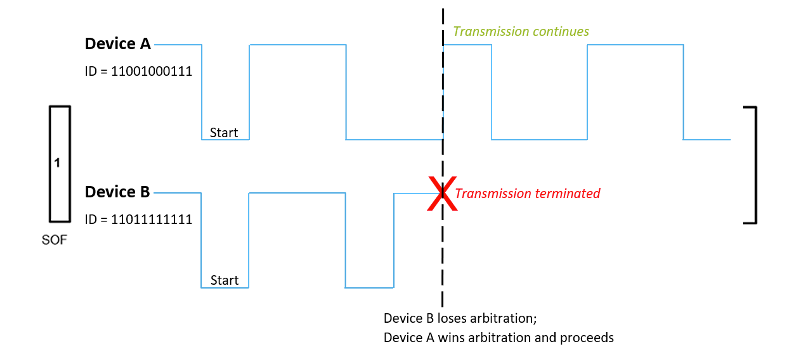

Priority Arbitration
The CAN protocol uses what is called lossless bitwise arbitration to determine message priority. Let’s break this down. While every node is capable of transmitting and receiving messages, only one message can occupy the bus at a given time. Bus access is event-driven, and it is possible for several nodes to begin a transmission at the same time. In this case, the message with the higher priority “wins” access to the bus first. Message priority is determined by looking at the arbitration ID bit by bit (aka bitwise) – the lower the binary identifier, the higher the priority (so a logic ‘1’ bit is recessive to a dominant ‘0’ bit). The node winning arbitration continues on with its message transmission, without the message being delayed, destroyed or corrupted by another node. This is called lossless arbitration. The node transmitting a lower priority message will halt transmission while the higher priority message transmits. Once the bus is released, this node will make another attempt to transmit its message.
To look at an example, let’s consider two devices trying to transmit simultaneously on the CAN bus, as shown in Figure 4 below. Device A has an arbitration ID of 11001000111. Device B has an arbitration ID of 11011111111. Device A would win access to the bus because it has a lower arbitration ID (the 4th bit being ‘0’). Device A proceeds with message transmission, and Device B waits to try again when the bus is free.
Priority Arbitration ExamplePriority Arbitration Example
Figure 4: Priority Arbitration Example
In addition to identifying the message in a transmission, the arbitration ID also determines message priority. A lower ID value gets higher priority. If multiple nodes try to transmit a message onto the CAN bus at the same time, the message with highest priority (lowest arbitration ID value) gets bus access. Lower-priority nodes must wait until the bus becomes available before they can attempt to transmit again.
