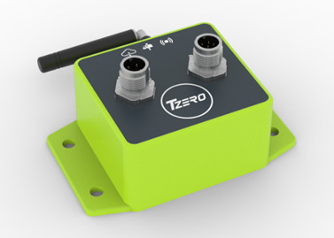

The Modbus specification is freely available and open.     There are an extremely large number of Modbus devices available on the market ranging for simple sensors to complicate actuators and motor controls.  A simple web search can return a large of number of product.   There are even Cellular Connected Industrial IOT available such as the TZero “MachineMailbox”.
Figure 2:   An example of an Industrial IOT Modbus Device.

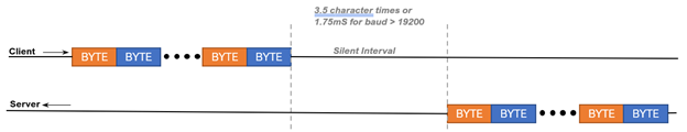

There is one detail when implementing Modbus-RTU with RS485 that requires some special consideration.    Modbus data packets, or PDUs, are simple binary packets transmitted via RS-485 signaling.     This means a UART is needed to send and receive data.   What makes Modbus different from other serial protocols is that data packets do not have explicit “end of frame” or “start of frame” bytes.  Frames must be sent as back-to-back characters.   The end of a packet is delineated by *idle time*.    This means that in addition to a UART, we need a timer to properly implement Modbus-RTU.  The Modbus specification indicates that there should be a minimum of 3.5 character times (<= 19200 baud) or 750uS (>19200 Baud) to delineate packets.
Figure 3:   Modbus Message Framing

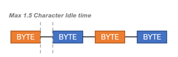

Modbus generally assumes 1- bit characters: 1 start-bit, 8 data-bits, 1 parity and 1 stop-bit.   In the case of no parity, 2 stop bits are specified.   It is common for modern devices to not require 2 stop bits.  As an example, a 19200 baud device should use an idle time of 2mS at the end of a packet. Modbus also specifies that there should never be more that 1.5 characters of idle time in bytes in a packet   This however is rarely an issue as most MCU can easily ensure that UART characters are sent back-to-back.
Figure 4:   Modbus Inter-character Timing

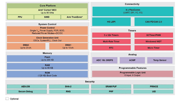

As packets are delineated by idle time, a timer is required to detect the end of a packet.      One of my favorite features of all NXP MCUs is the plethora of timers.    A good option for precision timeout applications is the “Multi-Rate Timer” or MRT.
Figure 5:   Timers in an NXP LPC MCU

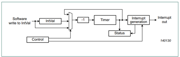

The MRT is a 4-channel 24-bit timer with 3 modes: Repeated Interrupt, One Short and One Short Stall.
Figure 6:   The NXP Multi-Rate Timer (MRT)

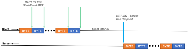

The MRT is a simple down counter than can fire an interrupt when the counter reaches zero.  It is the perfect option when all you need to implement a precision “timeout”.        For detecting Modbus packets, we can use the MRT interrupt in conjunction with the UART receive interrupt.
Figure 7:   Decoding Modbus Packets with an UART IRQ and an MRT IRQ
In the diagram above, the green arrow indicates when we receive a character and get an interrupt.    This is where we can start/reset the MRT for our 3.5-character timeout.    Every time a character is received, reset/restart the timer.    When the packet is complete, the MRT interrupt will fire and then we can consider the packet complete.  The data packet can then be processed, and the response can be transmitted to the client.   If you want your firmware to enforce the inter-character idle requirement, simply use another MRT channel to detect if there has be 1.5-character times between incoming bytes.

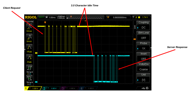

And to show you the timing from real world signals on the LPC55S06-EVK:
Figure 9:   Modbus Transmit/Receive Timing on the LPC55S06-EVK
I used a combination of interrupts on the UART and the MRT to detect the idle time at the end of a packet.   The setup was straightforward with the MCUXpresso SDK functions.
