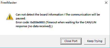

zhangrunhe
hello,
   Thank you very much,I have solved my previous problem, but I have encountered a new problem.I want to use freemaster to connect my MPC5744 DevKit via CAN. But there is a problem like the one shown.
PS: 1. I have completed the repair of hot fix_8.
          2. I use openSDA to connect freemaster to MPC5744 DevKit is normal.
    thanks very much and wait for your reply!
47,776 Views
thomsonzhou
Hi Zhang,
    Your problem is similar with my previous one.
This kind problem maybe caused by:
Firstly, The corresponding NXP demo software project for MPC5744 dismatch with your board.
Sometimes, the NXP demo board use external/internal oscillar but the demo software use internal/external oscillar.
Secondly, we suggest you  to pay your attention to the jumpers configuration for different connection cables. You need to read your demo board manual carefully. NXP board mainly have several connection methods including SCI, USB2UART, PEMicro, and openBDM.
All above connections have different jumper configurations.
So, please read the corresponding document carefully to make sure your jumers' configuration are exact.
47,776 Views

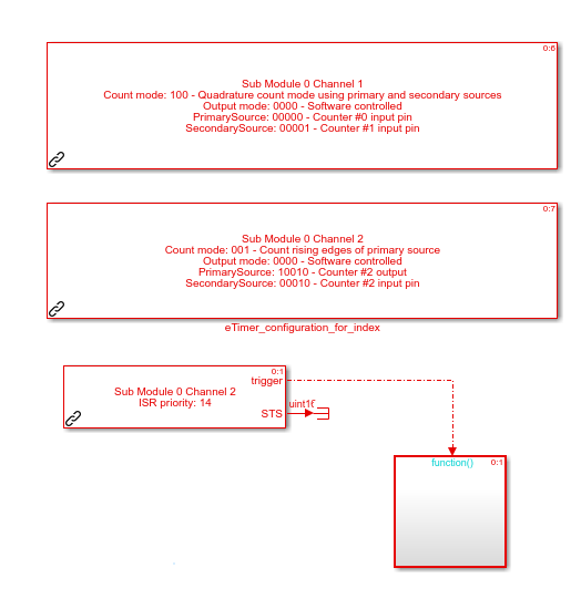

zhangrunhe
Hi,thomson
thanks for your help. I tried to use the etimer module of MBDT for MPC574XP to read the signal of the photoelectric encoder. I can get the count value of a certain etimer module, but I can't make the etimer module detect the pulse of the encoder index and then clear the value of the register captured by etimer. How can I do this?
PS, I used two etimer modules and one used for orthogonal decoding. Read the pulses of the A and B phases of the encoder. Another pulse is used to detect the index and generate an interrupt.module.png
47,776 Views
thomsonzhou
Dear Zhang,
    Sorry to reply too late. I was  on my business tour in last two weeks. I saw your problem. My answer is you can add a detection fucntion manually in the generated code. Or you can add one user define simulink function in your BLDC module.
   To detect the first and the second pulses, you need to be very familar with your NXP TIMERS, which is used for PWM signal detecting.
  To NXP MCU, it is much easier for PWM signal detecting. After read the MCU manual, you can find the timer exact registers description for the hex value of the registers.
  Usually, if you use pulse A and pulse B then you need to use one timer with two channels to detect the first clock time and the second clock time for your machine. After you get the two hex values you can evaluate the exact time, frequency and periods or any variable you want.
  The problem is you need to reset your clock before start your function because all of the clock counting need to start from zero clock time.
Good Luck!
Thomson
