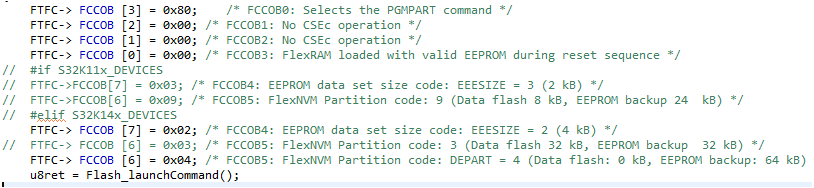

in the example named "Example_S32K144_EEEPROM_usage.zip" there are some writes in FlexRAM, but before each writes there is :
while ((FTFC-> FSTAT & FTFC_FSTAT_CCIF_MASK) == 0){}
This is mandatory?
There is the possbility to eliminate it ?
Thanks a lot.
well - this is mandatory in case that you are going to write continuously data portions. It can't be done before previous operation is done. You can do anything useful instead waiting till operation is finished. But be sure that before next write all previous writes are done.
Jiri

oValidation of FlexRAM as EEPROM and EEPROM backup in S32K144
Please verify my programming sequence
step 1:
The main function→init_EEPROM()
step2: init_FlexRAM()
Flash_launchCommand()
step 3:
EEE_Write_ByteArray(data,&FLEXRAM_START_ADD,strlen(data));
My Question:
1. is that mandatory to do the PE Configuration? If then once I did the Configuration, I should manually change the   s32K144_64_Flash.ld file as mentioned above.
2. If any configuration I have missed?
3. In the example program used SDK but my project not used SDK so, Should do the FLASH_DRV_init()?
4. When I used the init_EEPROM() function program not running as expected if this configuration wrong?
Please help me on this,
Sakthivel K

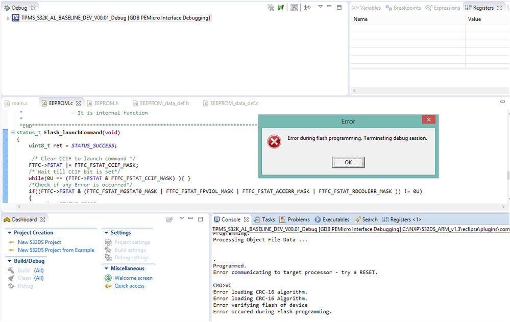

@ Jiri Kral
I have followed the PE Configuration,
1.Flash Memory setting
2. Manually change .ld file
3. I have used the same  data structure located in FlexRAM section by linker file
4. Build success, but during debugging below errors are occurring, Please let me know what could be the problems?
Console Log:

CMD>PA 0204
Started.
Done.
Programming sequency is : erase, blank check, program, and verify {default}
CMD>VC
Verifying object file CRC-16 to device ranges ...
block 00000000-000011AB ...
Calculated CRC-16 does not match block. (File = $BC61, Device = $4E54)
CMD>EM
Preserving data range $10000000-$1000FFFF before erase ...
Done.
Erasing.
Module has been erased.
Reloading programming algorithm ...
done.
Re-programming preserved data range $10000000-$1000FFFF ...
Done.
Error communicating to target processor - try a RESET.
CMD>PM
Programming.
Processing Object File Data ...
Programmed.
CMD>VC
Error loading CRC-16 algorithm.
Error loading CRC-16 Algorithm.
Error verifying flash of device
Error occured during Flash programming.
you can use eeeprom_io_control from example. I tried remove all SDK stuff - and for me it is working. I tested in with non-SDK hello word example.
Basically - only what is mandatory prior EEERAM usage is DFLASH partitioning (via PE Micro for example)  - and preserve memory from 0x10000000-0x1000FFFF from being rewritten by PE Micro.
You can check EEERAM readiness in FTFC->FCNFG->EEERDY register bit. Should be set to 1.
I'm going to add non SDK EEERAM usage example into example list later today.
Jiri

Case3: very first time when Debugger  runs this time no issue.
Case4: Next time same code start debugging problem has occurred as mentioned above post.
"Programmed.
CMD>VC
Error occured during Flash programming."
Please help me to resolve this, I'm stuck with this issue long time.
the non-SDK example is here: Example: S32K144 EEEPROM usage - No SDK - partitioning is done by software. There is hardcoded 64kB backup DFLASH. You can change the size by your requirements. Feel free reuse any part of the example.
Sometimes with PE Micro I got similar errors like you - especially when MCU is already partitioned and there is active memory preservation. The Emergency Kinetis Device recovery help fix the issue.
Jiri
