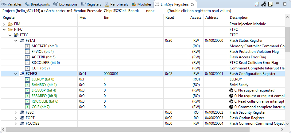

you can use eeeprom_io_control from example. I tried remove all SDK stuff - and for me it is working. I tested in with non-SDK hello word example.
Basically - only what is mandatory prior EEERAM usage is DFLASH partitioning (via PE Micro for example)  - and preserve memory from 0x10000000-0x1000FFFF from being rewritten by PE Micro.
You can check EEERAM readiness in FTFC->FCNFG->EEERDY register bit. Should be set to 1.
I'm going to add non SDK EEERAM usage example into example list later today.
