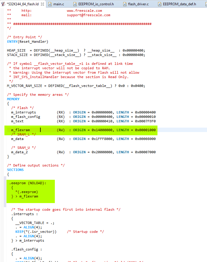

 Example shows how to configure PE Micro debugger to be able use FlexNVM as
 backup for EEEPROM - Emulated EEPROM  (Backup size 64kB, EEEPROM size 4kB) and preserve the backup
 memory. Configuration can be found in debugger Advanced Options.
 In the example is data structure located in FlexRAM section by linker file.
 FlexRAM data change cause flash store on background. Prior each data
 change you shall check if previous flash operation is done.
 In the example are two ways of FlexRAM (configured as an EEEPROM) usage:
  •  Direct access (up to 4 bytes can be stored once)
  •  IO Functions

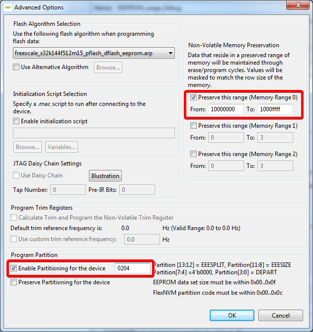

 PE Micro configuration:
 Enable partitioning for the device - code: 0x0204
 Preserve memory - range: 10000000-1000FFFF

[email protected]‌  In our project, we are using the Flex NVM block as 2 partitions -  16 kb as data flash for storing parameters and 48 kb as EEPROM. When I flash the application binary, I set it up to partition the NVM in the debug configuration as mentioned in the example above (with partition code 0x020A). In the application initialization phase, I am executing the Flash init function from SDK ret = FLASH_DRV_Init(&flash_InitConfig0, &flashSSDConfig); to check if the partition is ok. But, I see that the EEESize is reported as zero. It seems the partitioning does not happen.
I tried with the code 0204 as in your example and see the same result. Am I missing any step here?

0x020A is correct code - but the partitioning is write-once operation. If you use partitioning with PE Micro - you can't modify it in runtime, For me is your scenario working - I changed the example 0x0204 partitioning code to 0x020A:
Also make sure that DFLASH area in linker file (if you flash data into custom dflash section) doesn't exceed the 16kB size (0x10000000 to 0x10004000).

I may have figured out the solution myself. If I set the partition configuration in the debug configuration for all my files and also specify the memory preservation, I could see that the partition is maintained and the data in other areas are also preserved. For e.g: I used the configuration below for the file that resides in 0x1000000 to 100007FF. Here I set up the preservation for my application code at 0x0 to 0x7FFFF and for the other file at 0x10000800 to 0x100017FF. I also set up the partition to 0x020A. Now, when I flash this, the application reboots with the proper flexNVM partition.
But I dont understand what the option Preserve Partitioning for the device does. When I enabled this, the earlier partition configuration is cleared after flashing. I am not clear when this should be used and if this can be used along with the Enable Partitioning for the device  option

you can use eeeprom_io_control from example. I tried remove all SDK stuff - and for me it is working. I tested in with non-SDK hello word example.
Basically - only what is mandatory prior EEERAM usage is DFLASH partitioning (via PE Micro for example)  - and preserve memory from 0x10000000-0x1000FFFF from being rewritten by PE Micro.
You can check EEERAM readiness in FTFC->FCNFG->EEERDY register bit. Should be set to 1.
