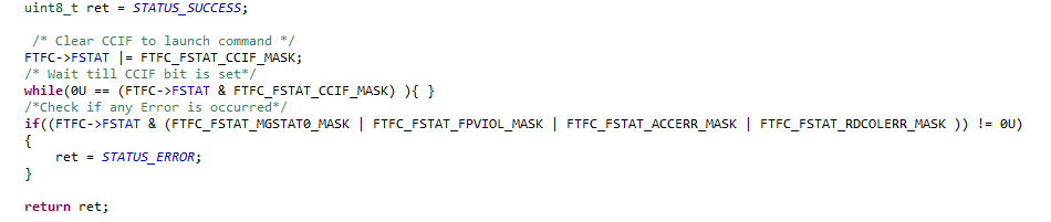

Thanks for your document, I have referred the document, One thing I'm not clear,
I have decided to use this option, for my project requirements means I have store the User configuration data(sensor ID (4byes *24), another configuration parameter), Could you suggest me this option is suitable for?
?above code snape "flash_launchCommand() " used for, what should I write the code for this function definition.
I'm still configuration of using Read and write sequence of EEPORM Usage for my Project.
Please give me the clear idea.
Sakthivel K

you can use eeeprom_io_control from example. I tried remove all SDK stuff - and for me it is working. I tested in with non-SDK hello word example.
Basically - only what is mandatory prior EEERAM usage is DFLASH partitioning (via PE Micro for example) - and preserve memory from 0x10000000-0x1000FFFF from being rewritten by PE Micro.
You can check EEERAM readiness in FTFC->FCNFG->EEERDY register bit. Should be set to 1.
I'm going to add non SDK EEERAM usage example into example list later today.
Jiri
