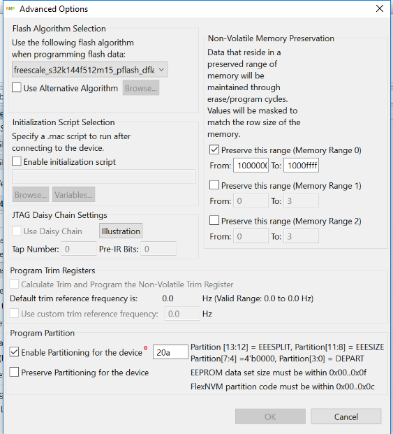

 Example shows how to configure PE Micro debugger to be able use FlexNVM as
 backup for EEEPROM - Emulated EEPROM  (Backup size 64kB, EEEPROM size 4kB) and preserve the backup
 memory. Configuration can be found in debugger Advanced Options.

 PE Micro configuration:
 Enable partitioning for the device - code: 0x0204
 Preserve memory - range: 10000000-1000FFFF

[email protected]‌  In our project, we are using the Flex NVM block as 2 partitions -  16 kb as data flash for storing parameters and 48 kb as EEPROM. When I flash the application binary, I set it up to partition the NVM in the debug configuration as mentioned in the example above (with partition code 0x020A). In the application initialization phase, I am executing the Flash init function from SDK ret = FLASH_DRV_Init(&flash_InitConfig0, &flashSSDConfig); to check if the partition is ok. But, I see that the EEESize is reported as zero. It seems the partitioning does not happen.
I tried with the code 0204 as in your example and see the same result. Am I missing any step here?

0x020A is correct code - but the partitioning is write-once operation. If you use partitioning with PE Micro - you can't modify it in runtime, For me is your scenario working - I changed the example 0x0204 partitioning code to 0x020A:
Also make sure that DFLASH area in linker file (if you flash data into custom dflash section) doesn't exceed the 16kB size (0x10000000 to 0x10004000).

I may have figured out the solution myself. If I set the partition configuration in the debug configuration for all my files and also specify the memory preservation, I could see that the partition is maintained and the data in other areas are also preserved. For e.g: I used the configuration below for the file that resides in 0x1000000 to 100007FF. Here I set up the preservation for my application code at 0x0 to 0x7FFFF and for the other file at 0x10000800 to 0x100017FF. I also set up the partition to 0x020A. Now, when I flash this, the application reboots with the proper flexNVM partition.
But I dont understand what the option Preserve Partitioning for the device does. When I enabled this, the earlier partition configuration is cleared after flashing. I am not clear when this should be used and if this can be used along with the Enable Partitioning for the device  option

there is an example related to your question - https://community.nxp.com/docs/DOC-335619
Jiri
Dear Jiri,
So we can direct to use the FlexNVM as EEPROM. Then what is the advantage to configure FlexRAM as EERPOM then FlexNVM as backup (1:16)? This can achieve better w/e cycle endurance? performance is more faster? (Because in term of memory usage efficiency,  direct using FlexNVM without FlexRAM for EEPROM implementation is better?)
Thanks and best regards
He Wei
you have three options. Use FlexNVM (which is technically Flash ROM) as an Emuletad EEPROM. This requires FlexRAM configured as EEEPROM. In this case, you have 4kB of EEEPROM and FlexNVM (64kB) is used as a backup for EEEPROM. In this case you don't need care about flash algorithm - you can simply write your data into FlexRAM (EEEPROM) and all data are automatically stored into FlexNVM.
Second option is using FlexNVM as a regular Program/Data Flash. In this case - you need some flashing algorithm if you like store data in runtime. In this case - you can use full 64kB of FlexNVM.
Third option is mix of both - part of FlexNVM for EEEPROM backup, part as Program/Data flash.
Hope it helps.
Jiri
Thanks Jiri for explanation.
