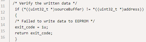

danielmartynek
The example code writes data to FlexRAM at 0x14000000 configured for EEPROM and then it verifies the written data by reading from the address.
/* Try to write data to EEPROM if FlexRAM is configured as EEPROM */
 if (flashSSDConfig.EEESize != 0u)
 address = flashSSDConfig.EERAMBase;
 size = sizeof(uint32_t);
 ret = FLASH_DRV_EEEWrite(&flashSSDConfig, address, size, sourceBuffer);
 if (ret != STATUS_SUCCESS)
 return ret;
/* Verify the written data */
 if (*((uint32_t *)sourceBuffer) != *((uint32_t *)address))
 /* Failed to write data to EEPROM */
 exit_code = 1u;
 return exit_code;
/* Try to update one byte in an EEPROM address which isn't aligned */
 address = flashSSDConfig.EERAMBase + 1u;
 size = sizeof(uint8_t);
 sourceBuffer[0u] = 0xFFu;
 return ret;
/* Then verify */
 if (sourceBuffer[0u] != *((uint8_t *)address))
 /* Failed to update data to EEPROM */
 exit_code = 1u;
 return exit_code;
12,743 Views

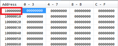

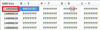

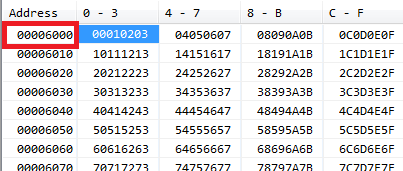

mrajanna
Contributor V
Hi Daniel,
In the flash program, sourceBuffer is used to demonstrate writing to p-Flash and FlexRAM.
For your Information: I have captured below screenshots after running the complete program in debug mode and when execution is at the end of main().
With reference to writing sourceBuffer to 6th sector(6*4096 = 0x00006000) of p-Flash, everything works good.
Below is the screenshot captured after writing some values to FlexRAM.
According to you EEE operation will take place in background and whenever data is written to FlexRAM it will update E-Flash. But in below screenshot, I don't see the values updated in E-Flash. This is my doubt.
But when board is rebooted above values are available in FlexRAM at same memory locations :smileyhappy:
I would like to write a log file(10KB size) which goes beyond FlexRAM size. In this case to which address of E-flash is log written ?
If EEPROM backup size is more than 4KB, then what part of E-flash is copied to FlexRAM ?
I understand E-flash size is 64KB, I want to make use of complete E-flash for saving critical data as EEPROM backup. Please guide.

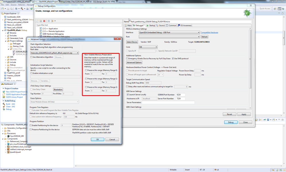

jiri_kral
Hi Mohan,
if you like to write more than 4kB of data - it is better idea write data directly into program flash (512 kB) or into FlexNVM used as a data flash (starting on address 0x10000000). To avoid re-write your data during debugging (re-flashing) - you can preserve part of Flash in advanced debug settings.
