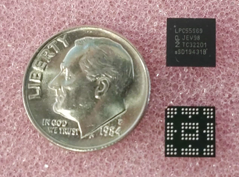

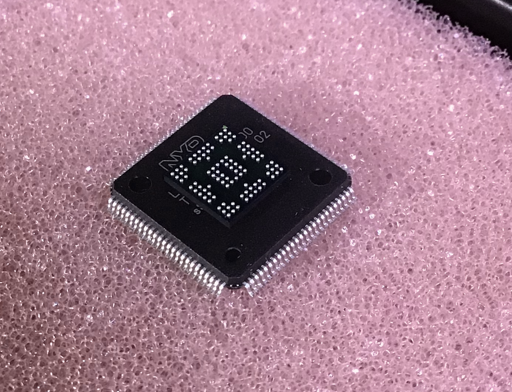

Many new projects start with development boards (such as the LPC55S69-EVK) to evaluate a platform and to take a 1st cut at some of the software development work.      Getting to a form-factor compliant state quickly can just as important as the firmware efforts.      Getting a design into a manufacturable form is a very important step in the development process.  With new hardware, I like to address all of my “known unknowns” early in the process so I almost always make my own test PCBs right away.  The LPC5500 series devices are offered in some easy to use QFP100 and QFP64 packages.      Designers also have the option of a very small VFBGA98 package option.     Many engineers flinch when you mention BGA, let alone a “fine pitch” BGA.     I hope to show you that it is not be bad as you may think and one can even route this chip on 2 layers.
Figure 1.  The LPC55S69 VFBGA98 Package. QFP100 comparison on the bottom.
The LPC55S69 is offered at an attractive price but packs a ton of functionality and processing power into a very small form-factor that uses little energy in both the active and sleep cases.     Having all of this processing horsepower in a small form-factor can open new opportunities.  Let’s see what we can get done with this new MCU.

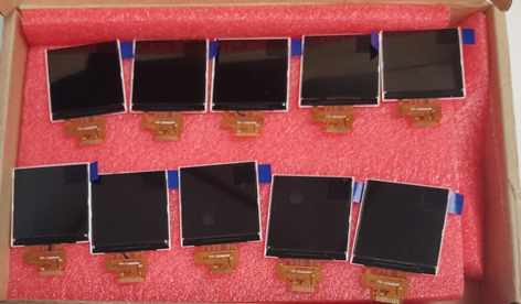

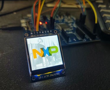

I recently found some absolutely gorgeous IPS displays with a 240x240 pixel resolution from buydisplay.com.   They are only a few dollars and have a simple SPI interface.  I wired a display to the an LPC55S69-EVK for a quick demonstration:
   Figure 2:  The LPC55S69EVK driving the 240x240 Pixel 1.54” IPS display.
It was difficult for me to capture how beautiful this little 1.54” display is with my camera.  You must see it to believe it!    Given the price I figured I would get a boxful to experiment with for this design project!
Figure 3:   240x240 Pixel 1.54” IPS display from buydisplay.com
