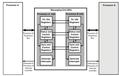

Since there are multiple CPU cores in the RT600, it is important to have hardware support for Inter-Processor Communication (IPC).  The RT600 includes a Messaging Unit (MU) which provides a hardware-based IPC mechanism.    While It is possible to setup shared memory between the CM33 and the Hifi4 DSP, the MU offers a way to efficiently send messages/notifications between the processors with interrupt support.    The MU is an important component to allow one CPU to wake up another when using power-down modes.
Figure 1.  The RT600 Messaging Unit.

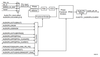

One last important component that I want mention (that is important to audio applications) is a dedicated Phased Locked Loop (PLL).    Audio IO protocols always require a dedicated master clock that is at some binary multiple of the target sample rate.   When using common audio sample rates such as 44.1KHz or 48KHz, the master clocks may not be aligned or easily derived from an internal MCU clock source.  For example, it is common to observe a 12.288MHz or 24.576MHz master lock when working with 48KHz audio streams.     The RT600 includes a dedicated PLL for audio applications.
Figure 4. RT600 Audio PLL.
