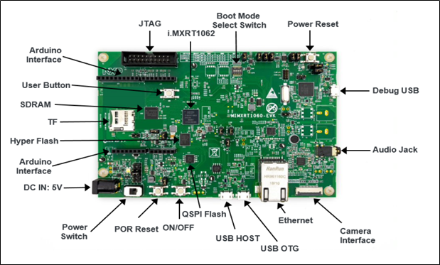

The MIMXRT1060 EVK board is a platform designed to showcase the commonly used feature of the i.MXRT 1060/1064 Processor in a small, not expensive package. It is an entry level development board that familiarizes the developer to the processor before investing on further resources for specific designs.
Some of the features of the MIMXRT 1060/1064 board are Mass Storage (TF Card Slot, 64 Mbit Quad SPI Flash, 512 Mbit Hyper flash), LCD Connector, Ethernet, USB, Audio Connector, Debug Connector (JTAG or OpenSDA), User Interface Buttons, Arduino Interface and many more.
Frontside overview of the MIMXR1060 EVK Board

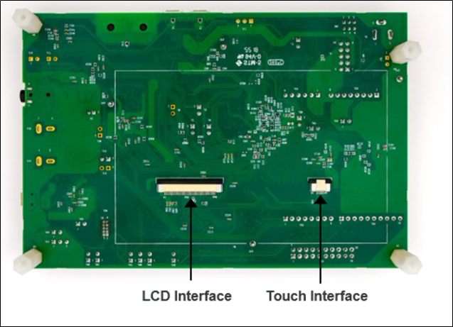

Backside overview of the MIMXRT 1060 EVK Board

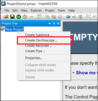

  • NXP FreeMASTER – an user-friendly real-time debug monitor and data visualization tool that enables runtime configuration and tuning of embedded software applications.

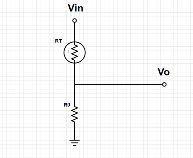

The model of the thermistor will be created from its circuit scheme:
KY-013 circuit
The module is nothing more than a voltage divider, but with a resistance that varies with temperature changes. In order to measure the temperature the value of the thermistor must be calculated.

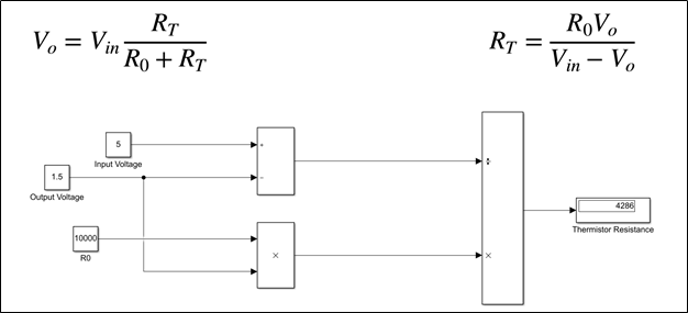

It is known that the output voltage of the circuit is based on the following formula:
From this the thermistor resistance value can easily get retrieved:
The following are known values: R0 = 10k Ohm, Vin = 5V and Vo is received from the IMXRT1060 board using an Analog-Digital Convertor (ADC) peripheral.

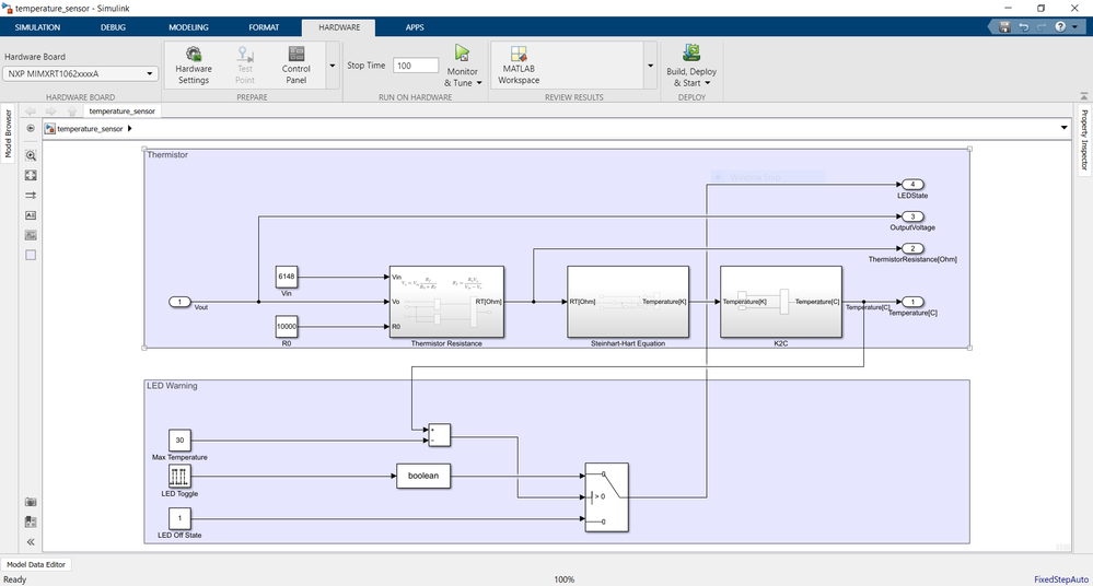

The aforementioned formulas will be modeled in Simulink using the available blocks in the Math Operations category in the Library Browser.
For this model a LED warning system model will be added. This warning will blink the user led on the EVK board when the temperature will exceed a specific threshold value set by the user in the model.
Model of the circuit
When running the above model the expected output of the thermistor’s resistance will be 4286 if a value of 1.5 is assigned to Vo. The next step is to use the obtained resistance value and compute the temperature.

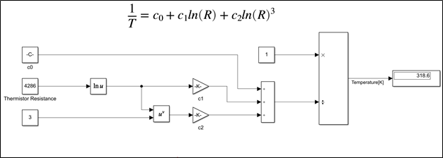

Next, we will find the temperature value using the thermistor's resistance.
The equation that models the temperature based on the thermistor values is called Steinhart-Hart equation and is the following:
Where:
  • T - temperature (K)
  • R - resistance at temperature T (Ohm)
  • c0,c1,c2 - Steinhart-Hart coefficients which vary from a thermistor to another
The following Simulink model will resolve the above equation:
Steinhart-Hart equation model
Simulate the model with the following values:
  • c0 = 0.001129148
  • c1 = 0.000234125
  • c2 = 0.0000000876741
The expected temperature value using a resistance of 4286 ohm will be 318.6 K.

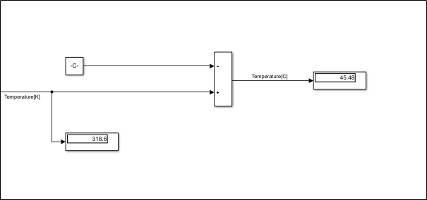

For a familiar output the temperature can be converted from K to Celsius or Fahrenheit:
Kelvin to Celsius conversion

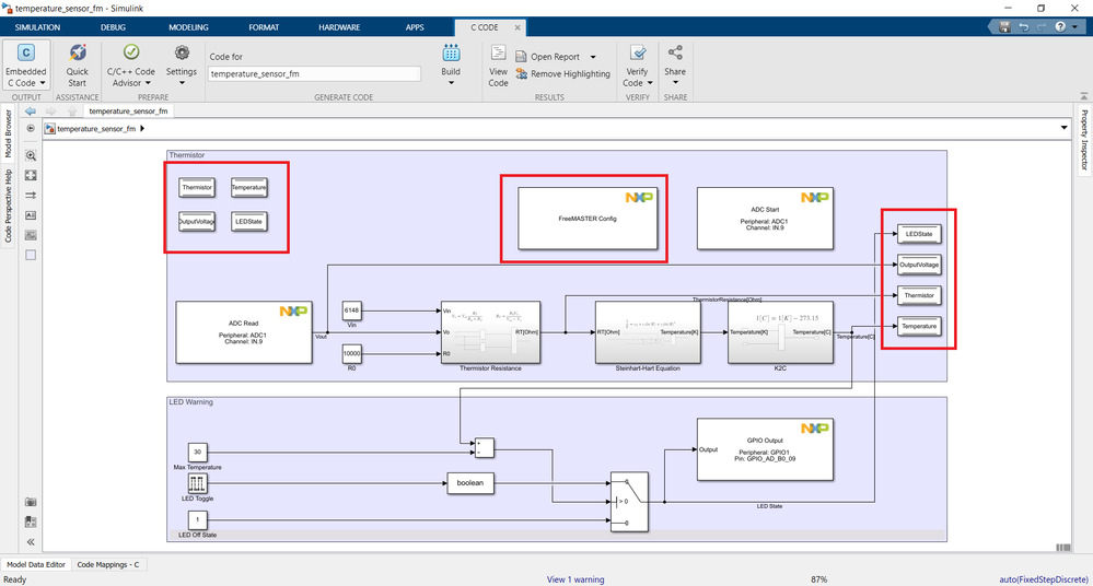

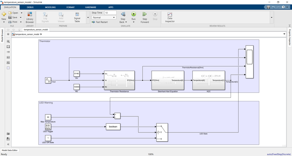

The following figure displays the application model. Notice that subsystems were created for the thermistor, the equation and the temperature conversion. The output voltage was replaced with a Sine Wave and the temperature, voltage, thermistor resistance and LED state are connected to a scope.
Also note that the input voltage of 5V was replaced with a numeric value of 6148. This is happening because the output voltage received from the thermistor will be in a digital form by using a 12-bit 3.3V ADC Peripheral.
Because the ADC converts value from 0 to 3.3V and a resolution of 12 bits is used, for 3.3V a value of 4095 is returned, and for 5V a value of 6148 is returned.
ADC formula
 Application model overview

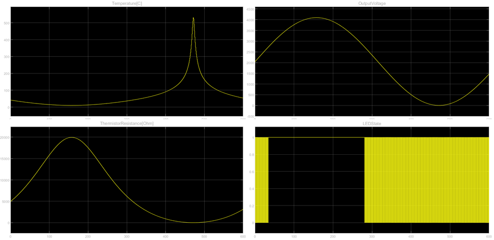

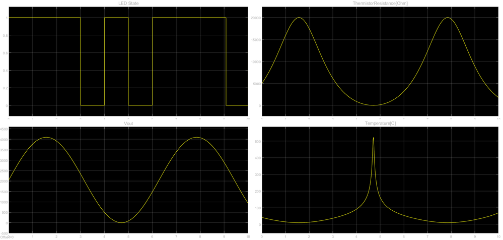

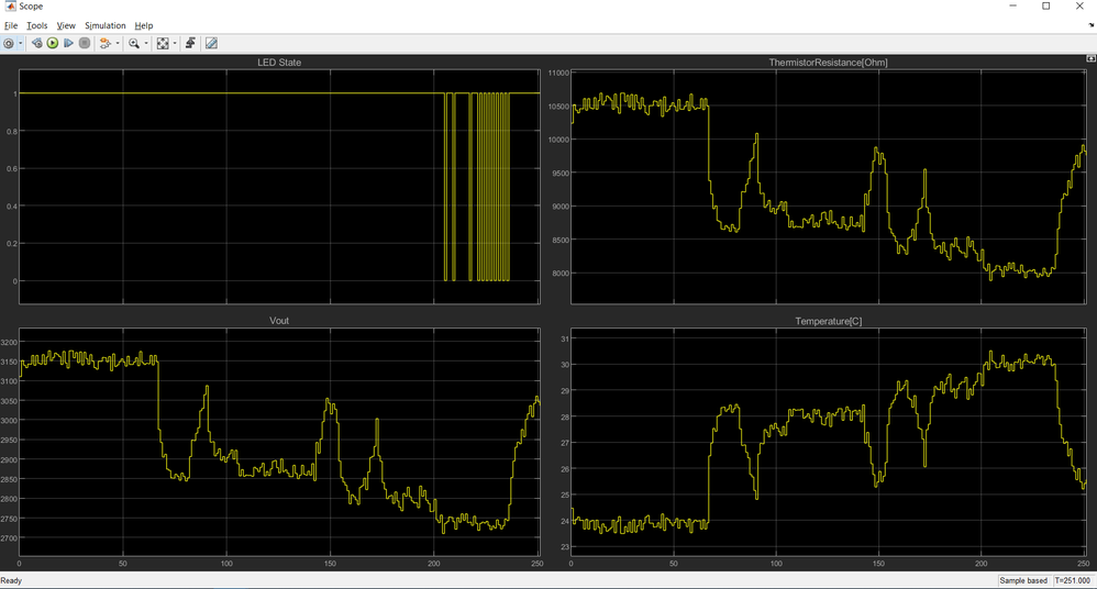

Scope outputs
In the scope it can be observed that when the output voltage decreases, the temperature increases as expected. When the temperature rises above the threshold value, the user led will start to blink.

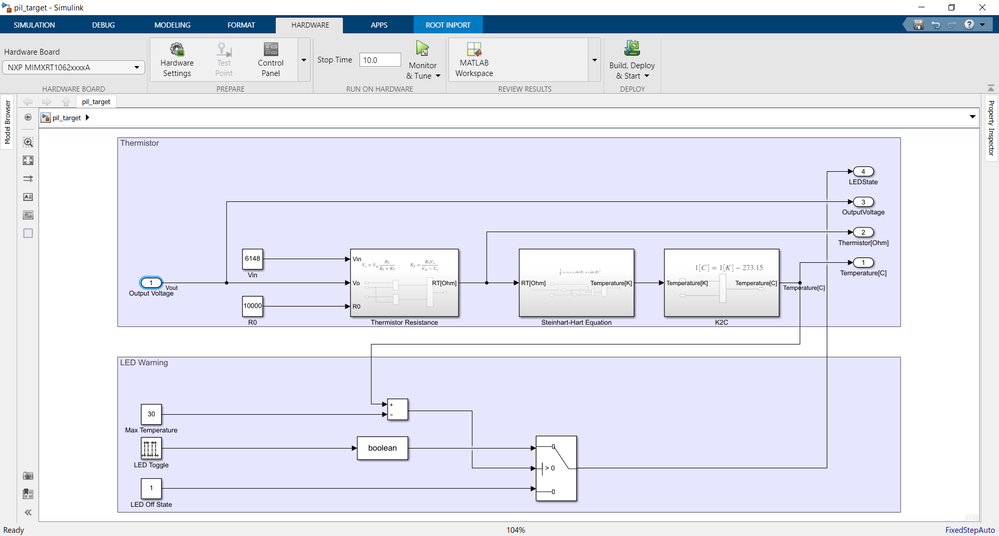

In a new folder create two models  "sil_target.mdl" and "sil_harness.mdl".
Open the "sil_target.mdl". This will be the application model. To save time, copy the content from the previous model-in-the-loop model.
Next replace the Sine Wave of the output voltage with an Input Port and the scope with four Output Ports. (Input Port and Output Port are found in Library Browser, Simulink > Ports & Subsystems)

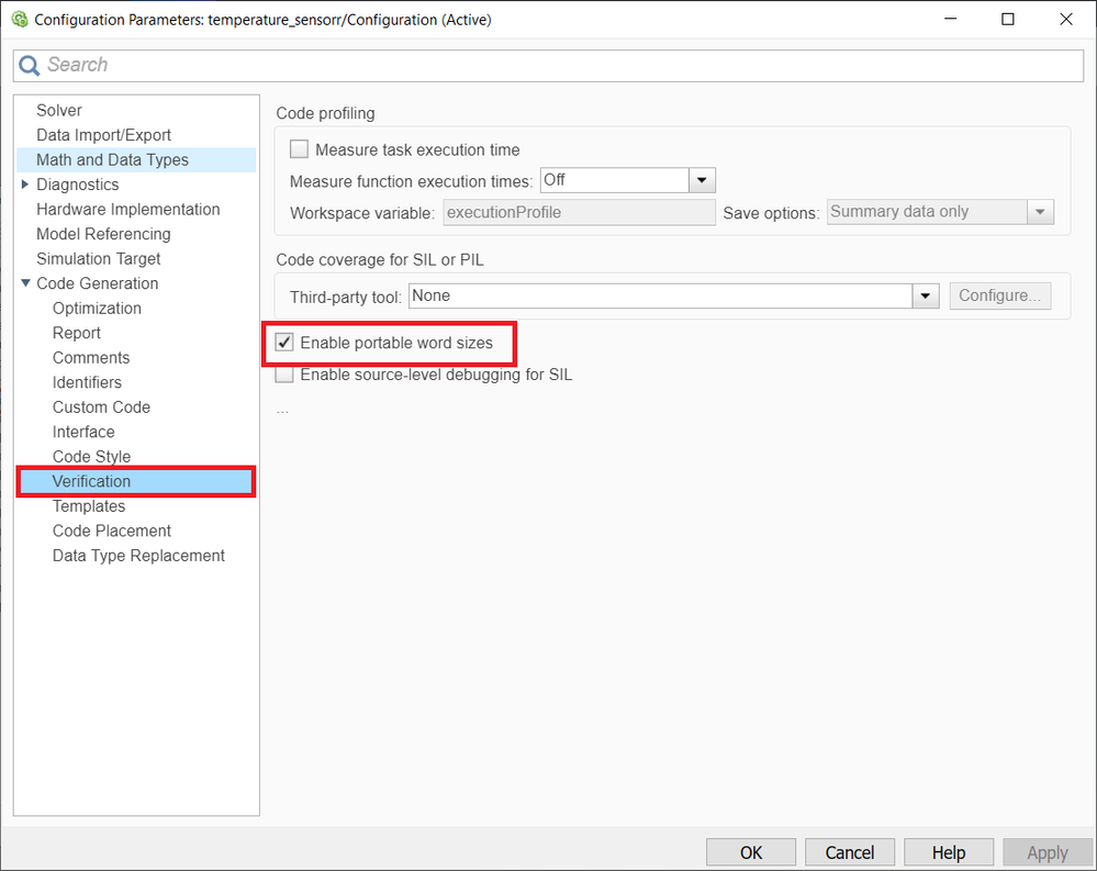

Make sure you have the following settings:

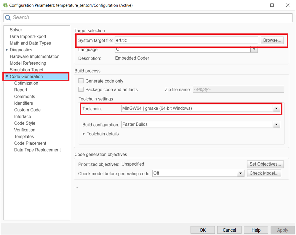

  • System target file set to ert.tlc in the Code Generation tab
  • Toolchain set to MinGW64 | gmake (64-bit Windows) in the Code Generation tab
  • Check Enable portable word sizes in Verification tab
  Model Settings windows
Target model overview

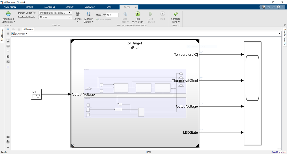

Save the target model and open the harness model. Make sure you have the same settings as pointed above.

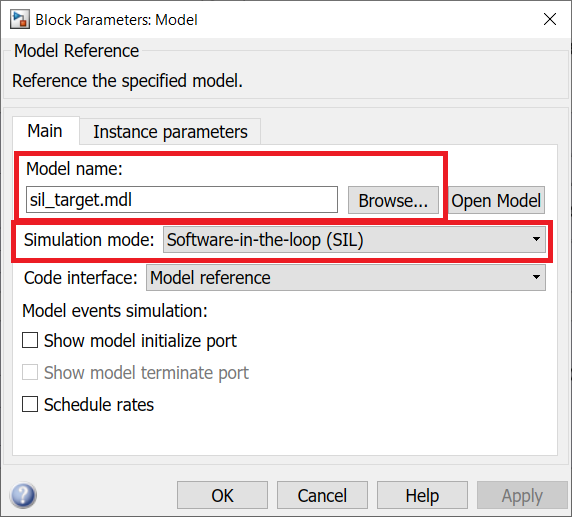

In the harness model insert a Model Block (Simulink > Ports & Subsystems). Right-click on it and open Block Parameters...
In this window, browse for the target model and set Software-in-Loop as Simulation Mode.
Model block properties

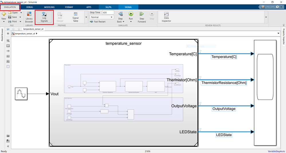

Add a Sine Wave block as an input to the model block and a scope for the outputs. Next the output signals will be logged for the Simulink Data Inspector, necessary for the verification.
To log the signals select them, then in the SIMULATION or SIGNAL tab press Log Signals.
Logged signals

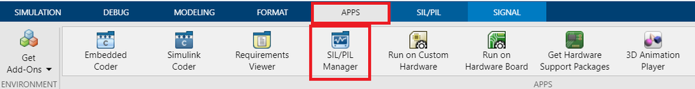

To start the validation, click on APPS tab, open SIL/PIL Manager. Press on MODE button and choose Automated Verification. Set Systems under test option on "Model blocks in SIL/PIL Mode" and Top Model Mode on "Normal". Choose the stop time and press on Run Verification button.
 SIL/PIL Manager menu

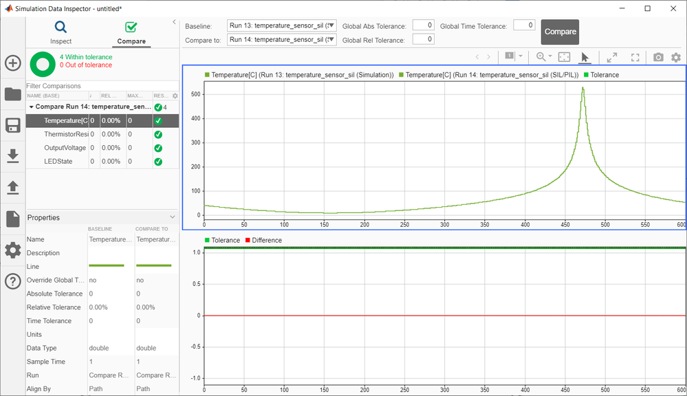

After the simulation and code generation is completed, the Data Inspector window will pop-up showing the results of the verification.
 Data Inspector results
As it can be seen in the above picture, the model has passed the verification step with all the output variables having 0% tolerance and difference.
Scope display of the output variables

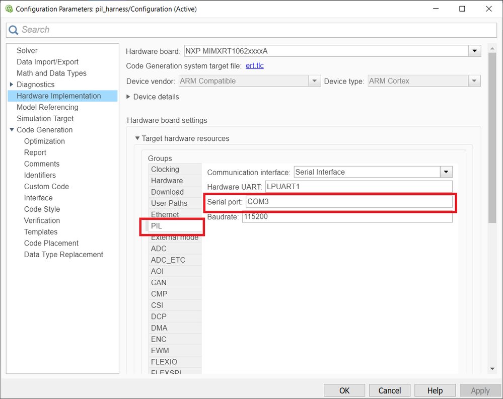

  • On the PIL group, select Serial port as the COM number of your board connection (To find the COM number, open Windows Device Manager program.
 Model settings

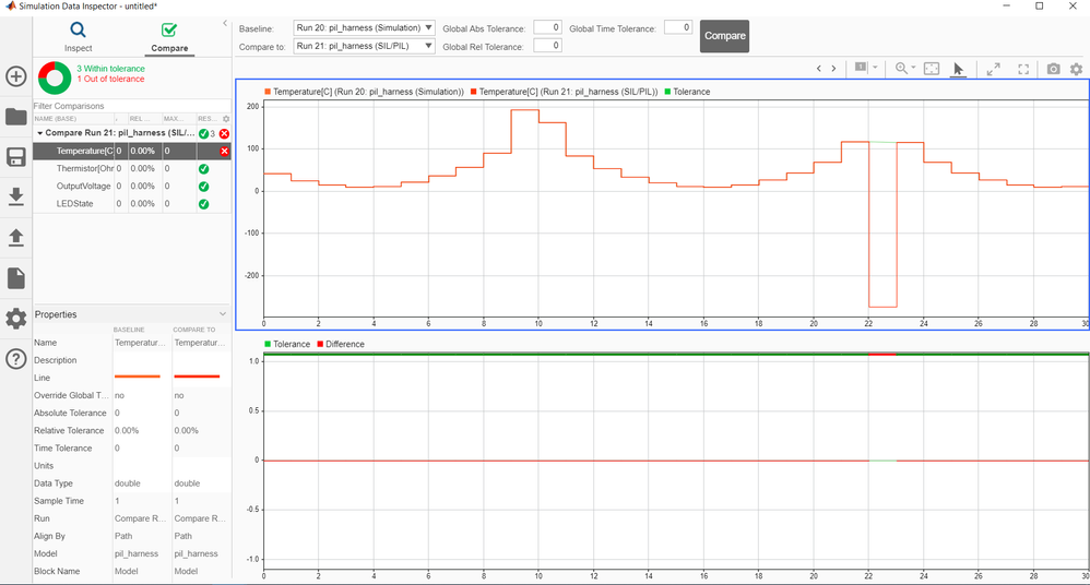

Similarly to the  the SIL verification, log the output signals, open SIL/PIL Manager and run the verification.
After the build is complete the following window will appear, reset the board and press OK.
Evaluation board restart pop-up window
It is noticeable that the verification fails at the 22-23 time period. This happens because at that period of time the thermistor resistance is zero and the temperature is computed using the natural logarithm, which is not defined for zero.
Therefore, based on the results it can be assumed that this stage of verification has passed.

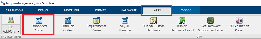

The application will get built by using two methods: External Mode and NXP FreeMASTER. The first way of building the application will be using External Mode.
External Mode
Simulink External Mode establishes a communication channel between a Simulink model and the targeted hardware. It grants real-time parameters visualization and real-time modifying of the model parameters.
First of all, create a new model named "temperature_sensor_extmode.mdl". Copy the content from one of the existing models created at the previous validation steps (i.e "temperature_sensor_model.mdl" in the MIL simulation).
Next, delete the Sine Wave block. The input of the model is the output voltage of the thermistor. In order to read a voltage using the MIMXRT1060 board an ADC (Analog-Digital Converter) is required.
Make sure the model is configured to the requirements of the board (check PIL Validation chapter for more details)
  • Hardware board : NXP MIMXRT1062xxxxA
  • In External Mode group under Target hardware resources in Hardware Implementation section select the specific Serial Port and check Verbose option.
 Model settings window
Apply the changes and close the model settings window.

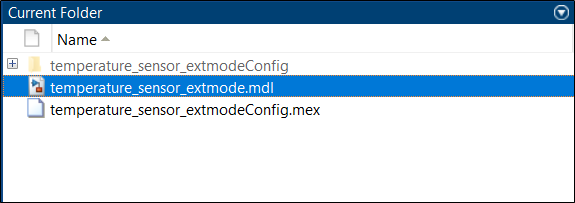

After this step, you can see that in the user workspace a file with .mex extension and a folder are created by the MCUXpresso Configuration Tool. The configuration folder is necessary in order to generate and build the application on the board. For more details on Simulink model creation for IMXRT targets see this quick start guide.
External mode simulation folder

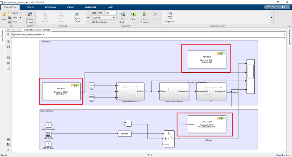

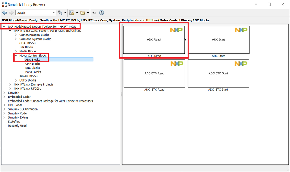

Now it is time to use add the NXP Simulink blocks to the model. In the Simulink Library Browser head to NXP Model-Based Design Toolbox for i.MX RT MCU's. To find the ADC Blocks go to i.MX RT1xxx Core, System, Peripherals and Utilities > Motor Control Blocks > ADC Blocks. Drag an ADC Read block into the model. An ADC Start block is also necessary to be added. This block is required in order to enable the peripheral when the application is built.
In the modelling stage, the input voltage was set to a digital value of 6148. It is known that the ADC Peripheral can convert voltage up to 3.3V (digital value of 4095). The question that pops is what if the output voltage is higher than 3.3V? There is a solution by adding an additional voltage divider in the circuit, but there is no need for anything because for an output voltage of 4095 the temperature reaches 10 °C  / 50 °F, which will never be reached for our application purposes.
To control the user LED board, a GPIO (General Purpose Input Output) block is required. The GPIO blocks are found in i.MX RT1xxx Core, System, Peripherals and Utilities > GPIO Blocks. Add a GPIO Output block to the model.
 Simulink model with the NXP IMXRT blocks

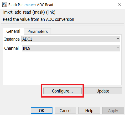

Next, these blocks must also be configured using the NXP MCUXpresso. Right-click on any NXP block in the model and press the Configure button.
NXP Simulink block properties

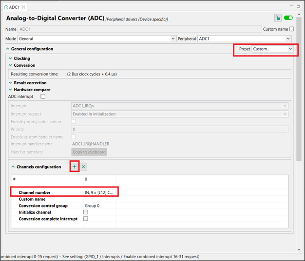

Now in the middle of the screen you should see the ADC configuration window. Here you can configure the peripheral parameter according to your application needs. For this application, make the following changes:
  • Preset : Default
  • Channel configuration : Press the + button. A table will appear. Click on Channel number and select IN, 9
Configuration window for the ADC peripheral
Note that this channel already has a pin configured in the default mex file.
If the user desires to configure another channel that is not configured by default, press on Channel number and choose IN,1; IN,2 or CHANNEL_DRIVEN_BY_ADC_ETC.
Be careful when assigning pins and channels that may generate conflicts with other peripherals.

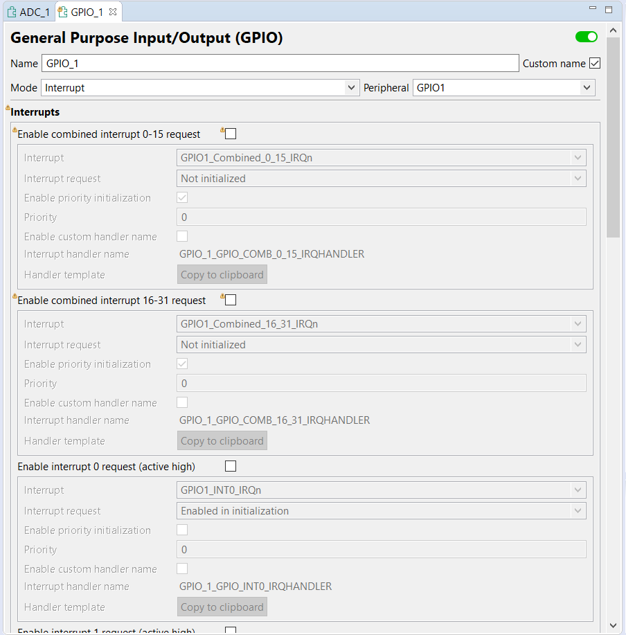

Next, configure the GPIO_1 peripheral by applying these simple changes:
  • Uncheck Enable combined interrupts 0-15 request
  • Uncheck Enable combined interrupts 16-31 request
 GPIO configuration window
The LPUART peripheral does not have to be modified. Save the changes by pressing Ctrl+S. You do not need to update the code as this operation happens automatically.

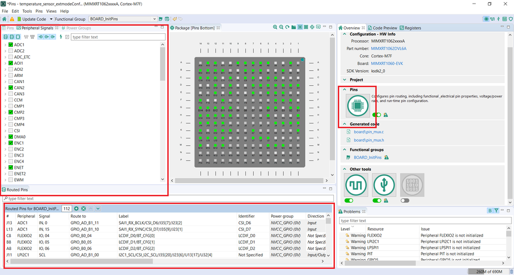

Next switch to the Pins tools in order to assign and configure the pins and signals to the peripherals.
 Pin configuration tool window
In the upper-left side of the picture there are the peripheral signals that can be routed or unrouted to the specific peripheral. Let's unroute all the peripheral signals, but keep the ADC1, GPIO1 and LPUART1.

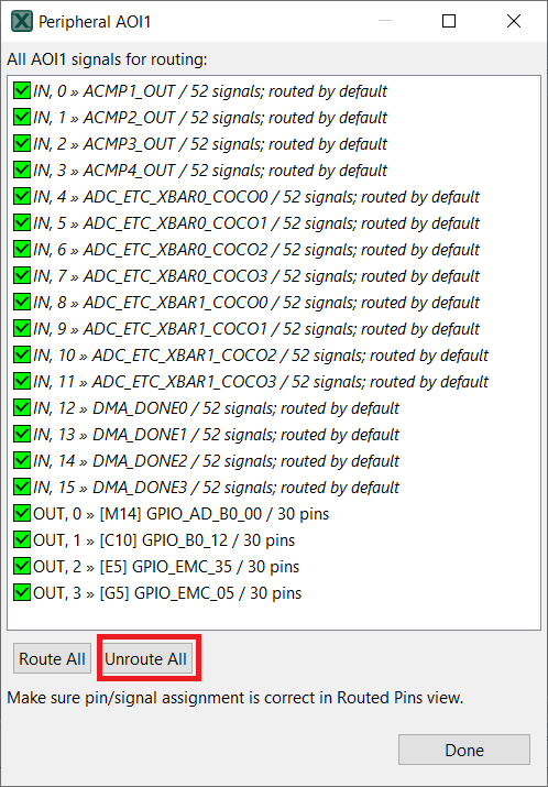

To unroute the signals simply click on the peripheral checkbox on the list and press the Unroute All button.
 Removing AOI peripheral signals

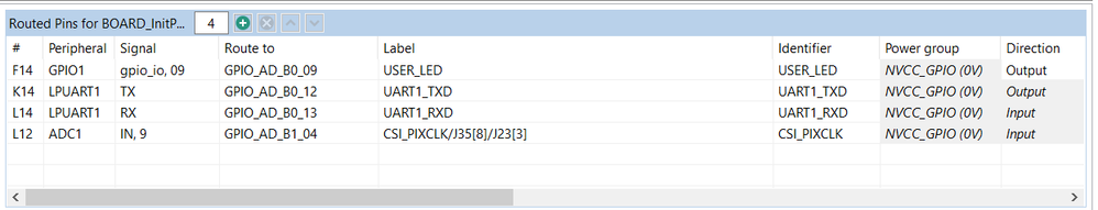

For the ADC peripheral check only the IN,9 signal. And for the GPIO peripheral check only the gpio_io,09 signal.
If everything is done right, the routed pins should look like this.
Routed pins

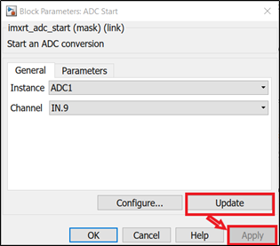

Back in your model, press Update on the ADC block in order to synchronize the mex configuration with the Simulink model and interface, then press Apply.
Update and applying the changes to the Simulink model

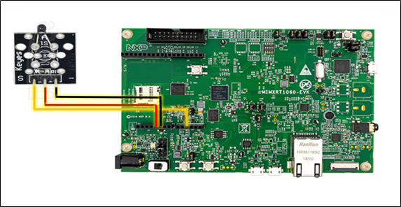

Before starting the external mode run, the thermistor module must be connected to the MIMXRT1060 EVK Board. The following table tells how to connect each pin of the module to the board.
S
Pin J23[3]
Pin J25[5]
Pin J25[6]
Hardware connection
Overview of the hardware
Note that is it safe to run the application without plugging the board to an external 5V supply. The OpenSDA port is enough to power the board and the thermistor module because the electrical current of the thermistor will be too small to affect the board.
Now that the hardware is configured and connected. It is time to run the external mode. To start the external mode click on HARDWARE tab in the Simulink model, make sure the hardware board is set to NXP MIMXRT1062xxxxA, choose your stop time and press Monitor & Tune button.
 External mode menu
 Scope results
In the scope you can see the results of the external mode. To rise the temperature you can pinch the thermistor. As expected, for a threshold of 30 degrees Celsius, the LED starts blinking when the temperature exceeds the value.

Once again, to save time, copy the content of the external mode Simulink model to a new model called "temperature_sensor_fm.mdl". Make the same configurations as described in External Mode chapter.
Open the model and remove the scope.
In order to create a communication between Simulink model and FreeMASTER software we need to add Data Store blocks.
In the Library Browser go to Simulink > Signal Routing and add into the model four Data Store Memory blocks.
A FreeMASTER Config block must also be added into the model. It can be found in the Utility Blocks > FreeMASTER Blocks.

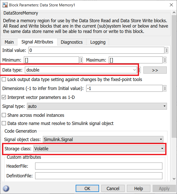

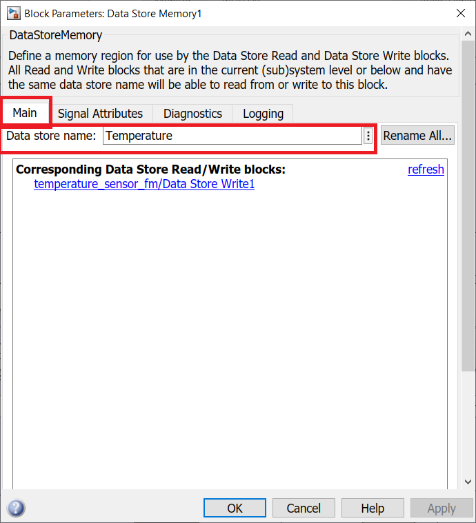

Double click on each Data Store Memory block and make the following changes:
  • Set an appropriate Data store name in the Main tab
  • Select Data type "uint32" for the output voltage, "boolean" for the LED state and "double" for the other blocks.
  • Set Storage class on Volatile in the Signal Attributes tab
Data Store block properties

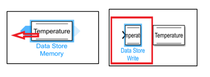

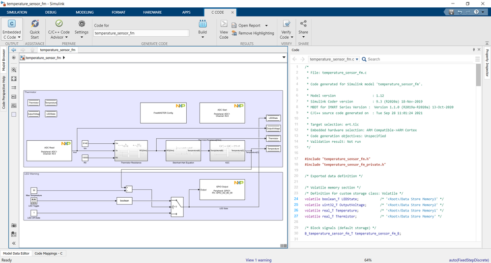

Add Data Store Write to the model. You can do it manually on the Library Browser or you can click or the Data Store Memory block, hold left-click on the left arrow and swipe to the left.
Connect each Data Store Write to its correspondent variable. The model should look as the following figure:
 Simulink model

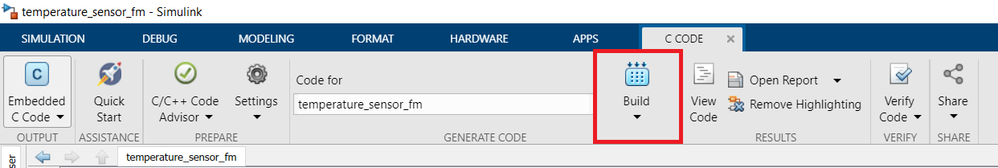

Make sure you have the same model settings as in the external mode model. In order to build the application on the board, complete the following steps:
  • Click on the APPS tab in the Simulink model
  • Click on Embedded Coder button
  • Press the Build button
 Embedded Coder menu
If everything is configured well, the application will get downloaded on the board and on the Simulink model will appear the generated code.
Model with the generated code

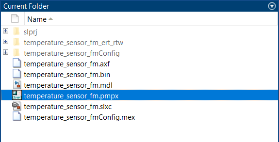

Open the FreeMASTER program.
Save the project in the folder with the other Simulink model and configuration files.
FreeMASTER project file in the Simulink model folder

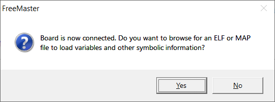

  • Click Yes to browse for an ELF or MAP file.
Selecting the UART Port and the baud-rate
Browse for the ELF or MAP file

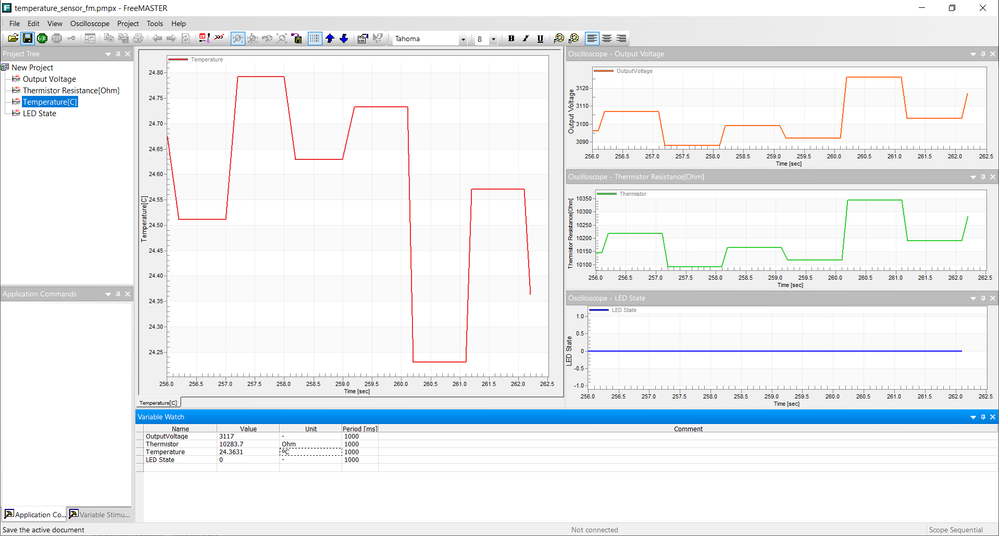

Now the application will start but no data is available because no data are selected for display.

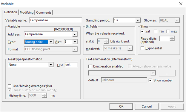

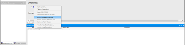

In the bottom of the screen, right-click on the table and press "Create New Watched Var..."
Right-click on the Variable Watches window in the bottom of the screen and press Create New Watched Var..
Create a new watched variable
A window will open. Here you can set a name for a variable, the address of the variable and its format. Add the four variables: Temperature, Thermistor, LED State and Voltage. For the Output Voltage set "unsigned int" and "float" type for the others . You can also specify the unit for each variable in the Real type transformation section.
 Variable options menu
Press apply and OK. In the bottom screen you should now see your three variables.
Table of watched variables
Now let’s add some plots for our variables.
Right-click on New Project under Project Tree in the upper left corner and click Create Oscilloscope …
Creating an oscilloscope
In the Main Settings tab give the name of your oscilloscope and in the Variables tab press the Add Variable button. In the Variable section in the lower left section, press the arrow and choose the wanted variable.
Add variable to oscilloscope
When you added all the oscilloscopes needed, press OK. Now, back on the main screen, press the green Go! Button. Now the application is running. To see the oscilloscopes, double click on each one of them in the left. To add multiple windows, simply right-click on the oscilloscope and press New window.
FreeMASTER project overview
