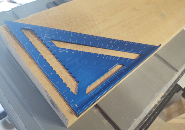

One of the first things we might want to do to with this specimen is use some sort of standard gauge to compare it to:
Figure 3.  Comparing our wood against a reference.
We can pick a standard unit and compare our specimen to a scale based upon that unit.   In my case the unit was “inches” of length, but it could be anything that helps up solve our problem at hand.  Often you want to pick a unit and coordinate system that scales well to the problem at hand.     If we want to measure circular “things”, we might use a protractor as it makes understanding the measurement easier.    The idea is to work in a system that is in the “coordinate system” of your problem.     It makes sense to use a ruler to measure a “rectangular” piece of wood.

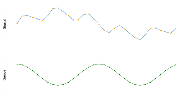

This particular signal is a bit more complex than the simple sine wave used in previous articles.     How exactly would we “gauge” this signal?   Amplitude?  Frequency?  Compute statistics such as variance?    Most real-world signals can have quite a bit of complexity, especially when they are tied to some physical process.    For example, if we are a looking at the result of some sort of vibration measurement, the signal could look very complicated as there are many physical processes contributing to the shape.   In vibration analysis, the physical “things” we are examining with move and vibrate according to well understood physics.     The physics show that the systems can be modeled with even order differential equations.       This means always be we can write the behavior of the system over time as the sum of sinusoidal oscillations.        So, what would be a good gauge to use to examine our signal?    Well, we could start with a cosine wave at some frequency of interest:
Figure 5.   Gauging our signal against a cosine wave.
Choosing a cosine signal as a reference gauge can simplify the problem as we can easily identify the properties of our unit of measure,  i.e. its frequency and amplitude.      We can fix the amplitude and frequency of our reference and then compare it to our signal.     If we do our math correctly, we can get a number that indicates how well correlated our input signal is to a cosine wave of a particular frequency and a unit amplitude.     So, how exactly do we perform this correlation?     It turns out to be a simple operation.    If we think about the input signal and our reference gauge as discrete arrays of numbers (i.e. vectors),  we can compute the dot-product between them:

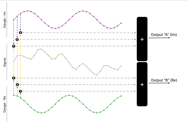

Figure 9.  Using two reference gauges.  One is “rotated” 90 degrees.
In figure 9, I added another “gauge” labeled “A” in purple.  The original gauge is labeled “B”.    The only difference between the two gauges is that B is phase shifted by 90 degrees.   This is equivalent to rotating my ruler in figure 8 and measuring the “width” of my board.     In figure 9, I am showing 3 of the necessary multiply/add operations but you would carry out the multiple/add for all points in the signal. Writing it out:
B = x[0]*Re[0]  +  x[1]*Re[1]  + x [2]*Re[2] +  .  .  .
A = x[0]*Im[0]  +  x[1]*Im[1]  + x [2]*Im[2] +  .  .  .
In this new formulation we get a pair of numbers A,B for our output.   Keep in mind that we are gauging our input against a *single* frequency of reference signals at a unit amplitude.     This is analogous to measuring the length and width of our block of wood.      Another way of thinking about it is that we now have a measuring tool that evaluates along 2 axes which are “orthogonal”.     It is almost like a triangle square.
Figure 10.  A two-axis gauge.
Once we have our values A & B, it is typical to consider them as a single complex number
Output = B + iA

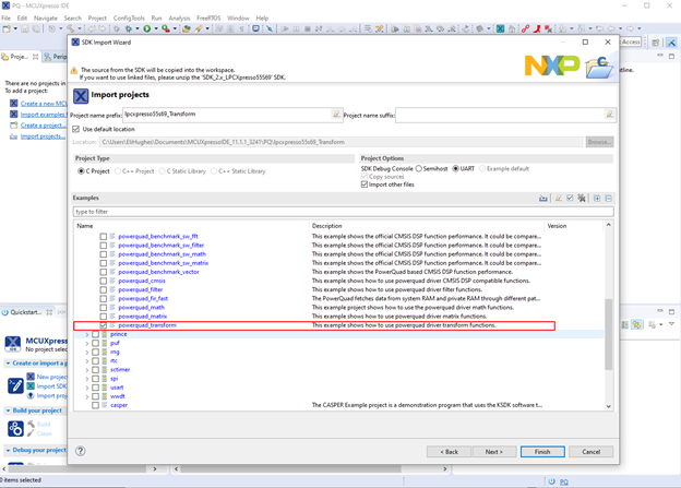

Figure 13.  PowerQuad Transform examples in the MCUXpresso SDK for the LPC55S69

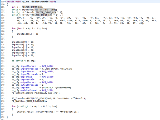

In the file powerquad_transform.c, there are several functions that will test the PowerQuad engine in its different modes.     For now, we are going to focus on the function PQ_RFFTFixed16Example(void).
This example will set up the PowerQuad to accept data in a 16-bit fixed point format.      To test the PowerQuad, a known sequence of input and output data is used to verify results.     The first thing I would like to point out is that the PowerQuad transform engine is used fixed point/integer processing only.   If you need floating point, you will need to convert beforehand.  This is possible with the matrix engine in the PowerQuad.      I personally only every use FFTs with fixed point data most of my source data comes right from analog to digital converter data.       Because of the processing gain of the FFT, I have never seen any benefit of using a floating-point format for FFTs other than some ease of use for the programmer.   Let us look at the buffers used in the example:
Notice that the input data length FILTER_INPUT_LEN (which is 32 samples).   The arrays used to store the outputs are twice the length.     Remember that an FFT will produce the same number of *complex* samples in the output as there are samples for the input.     Since our input sample are real values (scalars) and the outputs have real/imaginary components, it follows that we 2x the length to storage the result.     I stated before that one of implications of the FFT with real valued inputs is that we have a mirror spectrum with complex conjugate pairs.   Focusing on the reference for testing the FFT output in the code:
The 1st pair 100,0 corresponds to the 1st bin which is a “DC” or 0Hz component.  It should always have a “zero” for the imaginary component.    The next bins can be paired up with bins from the opposite end of the data:
76,-50  <->   77,49
29,-62   <->   29, 61
-1, -34   <->  -1,33
These are the complex conjugate pairs exhibiting mirror symmetry.   You can see that they are not quite equal.  We will see why in a moment.  After all the test data in initialized, there is a data structure used to initialize the PowerQuad:
One of the side effects of computing an FFT is that you get gain at every stage of the process.   When using integers, it is possible to get clipping/saturation and the input needs to be downscaled to ensure the signal down not numerically overflow during the FFT process.     The macro FILTER_INPUTA_PRESCALER is set to “5”.    This comes from the length of the input being 32 samples or 2^5.     The core function of the Radix-2 FFT is to keep splitting the input signal in half until you get to a 2-point DFT.  It follows that we need to downscale by 2^5 as we can possible double the intermediate results at each stage in the FFT.       The PowerQuad uses a Radix-8 algorithm, but the need for downscaling is effectively the same.      I believe that some of the inaccuracy we saw in the complex conjugates pairs the test data was from the combination of an input array values that are numerical small and the pre-scale setting.   Note that the pre-scaling is a built in hardware function of the PowerQuad.
The PowerQuad needs an intermediate area to work from.  There is a special 16KB region starting at address 0xe0000000 dedicated to the PowerQuad.   The PowerQuad has a 128-bit interface to this region so it is optimal to use this region for the FFT temporary working area.  You can find more details about this private RAM in AN12292 and   AN12383.

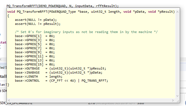

Once you configure the PowerQuad, the next step is to tell the PowerQuad the input and result data is stored with the function PQ_transformRFFT().
Notice in the implementation of the function, all that is happening is setting some more configuration registers over the AHB bus and kicking off the PowerQuad with a write to the CONTROL register. In the example code, the CPU blocks until the PowerQuad is finished and then checks the results.    It is important to point out that in your own application,  you do not have to block until the PowerQuad is finished.      You could setup an interrupt handler to flag completion and do other work with the general purpose M33 core.  Like I stated in my article on IIR filtering with the PowerQuad,   the example code is a good place to start but there are many opportunities to optimize your particular algorithm.   Example code tends to include additional logic to check function arguments to make the initial experience better.    Always take the time look through the code to see where you can remove boilerplate that might not be useful.
