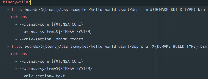

           2. Create more than one binary file with speical options, and file's path could be translated to relative path.

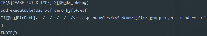

               For example:1.png           3.  Support to add target specific files, you can add targets for source file. For example:
1.png                And files will be added to cmakelist file as the way:
