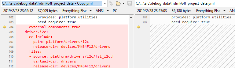

  • SDKGEN-829 Support debug component and debug mode
    • The debug component will only be visible when generator is running in debug mode. User can use parameter "--debug_mode" to enter debug mode. Without --debug_mode, these components will not appear in projects/manifest/packages/cmsis pack
    • The debug component should be added into yml data record with debug_support: true
      For example, add tag in I2C component yml:
               Run batch with --debug_support and without --debug_support, the component which set debug_support to true has been removed in non debug mode.

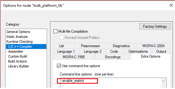

  • SDKGEN-827 Support extra option in lib project for IAR
    • For IAR application project, the extra options configuration of compiler fags have already been supported.
              In this Jira, the same feature has been enabled for IAR library project. User can configure cc-flags in yml data,                so they will be set in project definition file.
              For example:

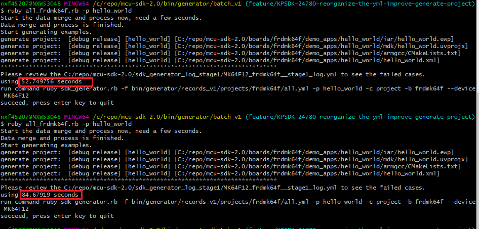

  • SDKGEN-838 Don't load large but not necessary ymls when just generating projects.
    • The aim of this JIRA is to accelerate the process for only project generation(-p project): There are some large but necessary ymls like docs.yml(for only project generation). Generator shouldn't load them thus can accelerate the process.
    • For manifest/package/cmsis pack, all ymls will be loaded anyway.
    • As follow is load and don't load the doc yaml compare:
