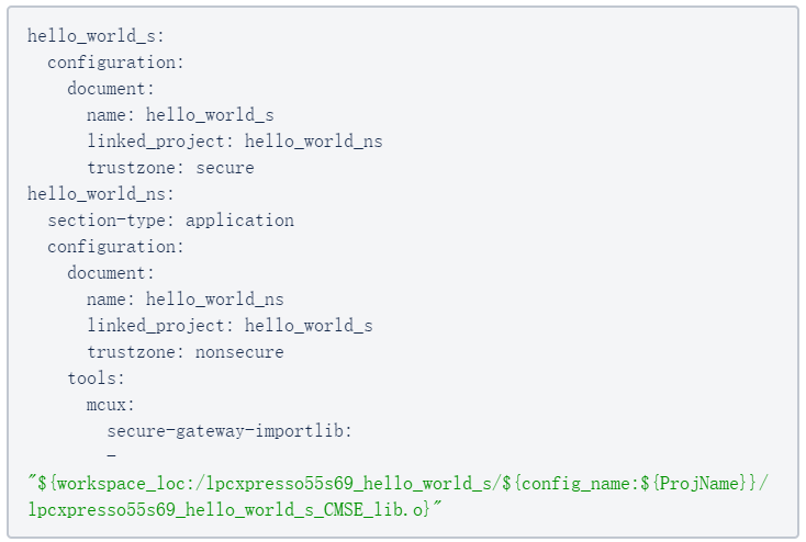

New features update:
  •  SDKGEN-924Support to automatically link secure and non-secure projects in Mcuxpresso IDE
        This feature supports to link trustzone projects. In MCUXpresso IDE, if you select a secure project or non-secure         project, the other trustzone paired project will be selected automatically.
        In order to enable the feature, "linked_project" need to be set for both projects.
        Here is an demo example:
        For more detailed trustzone settings, please refer to yml data record guide doc.
  •  SDKGEN-915Support to add preprocess cmd in cmakelist
        There is a requirement which needs to preprocess the original linker file with commands. For this reason, the         CMakeLists needs to call preprocesser.
        To add preprocess cmd in cmakelist file, need to add 2 flags in yml:
           ○ preprocessed: give the path of preprocessed linker file
           ○ Prebuild: give commands to preprocess linker file
        Here is an example:
