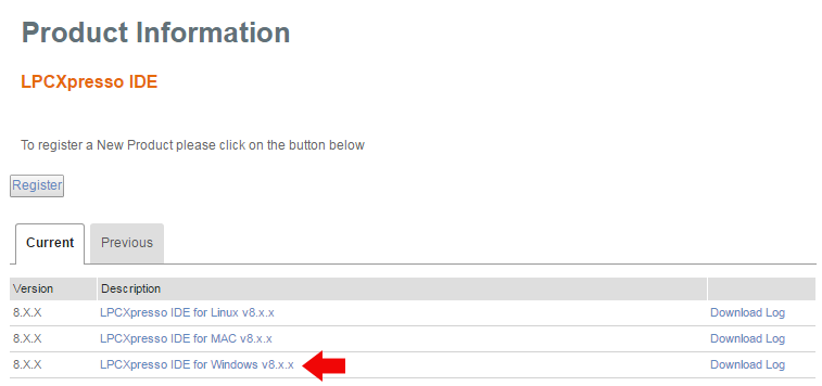

  4. Once you've selected your operating system you will be presented with the following options
    3.pngIt is always recommended that you download the most recent version of the IDE but links are provided for previous editions, if necessary.  Clicking on the link automatically starts the installer. Each installer serves as a standalone package. If you are upgrading to the newest version, keep in mind that the old version remains on the computer. You may opt to manually uninstall old versions.

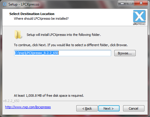

  5. Once you launch the installer and agree to the licensing terms, you will be prompted for an installation directory. Use the default directory.4.png
    Note: C:\nxp contains all LPCXpresso installations. You can open previous versions here if needed.

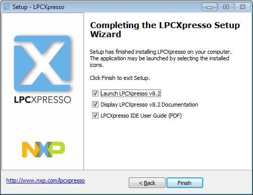

  6. Once the software installation finishes you will be prompted to install various drivers. You can select "Always trust software from 'NXP Semiconductors USA. Inc.'" to not have to individually approve each driver's installation.
  7. You will be presented with the following window once the installation process has completed. You are free to review the version documentation and the IDE User Guide if you wish.

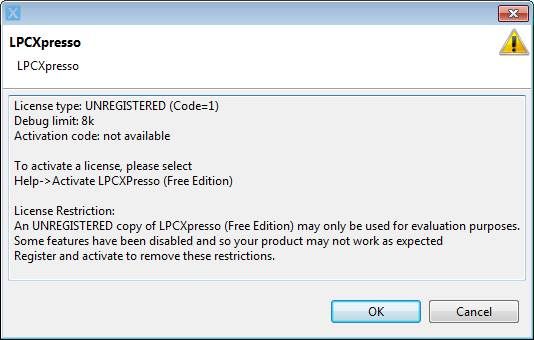

  8. Once you launch LPCXpresso for the first time, you will be presented with the following window letting you know that you do not have an active license for the IDE. This limits you to debugging code up to 8k in size.7.jpg

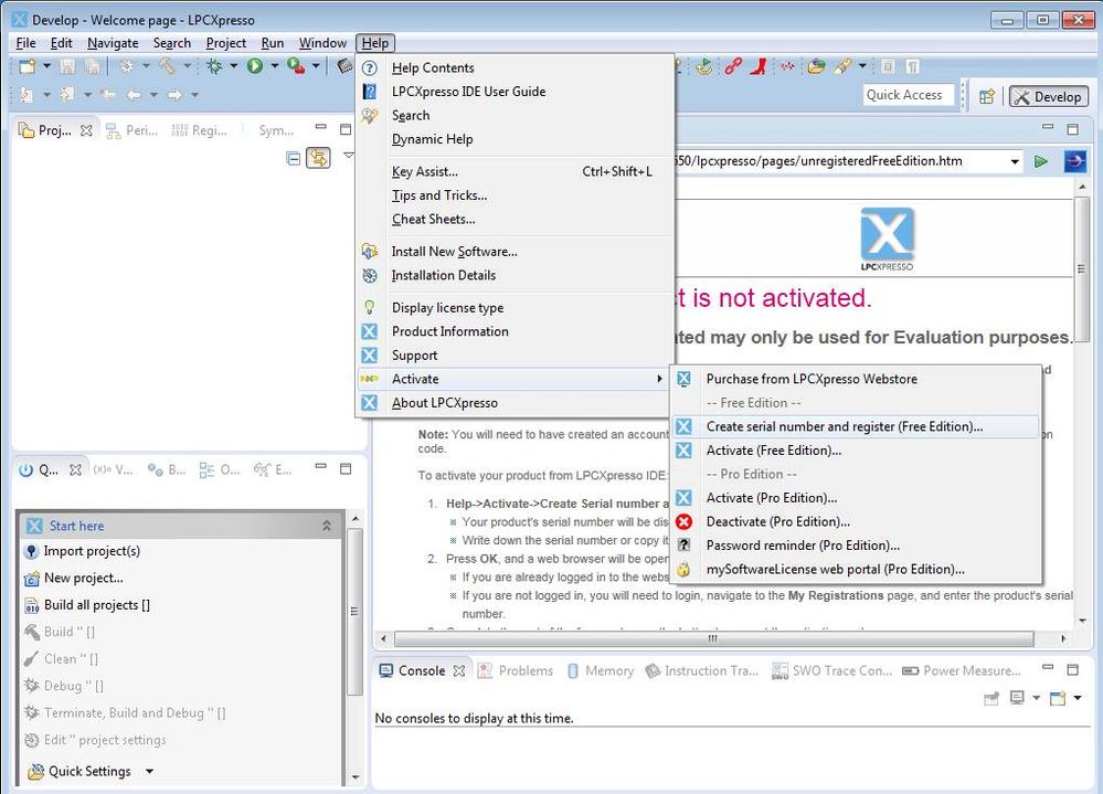

  9. In order to increase this limit we need to request a free license by clicking on help in the task bar. Then scrolling down to "Activate" and selecting "Create serial number and register (Free Edition)"8.jpg

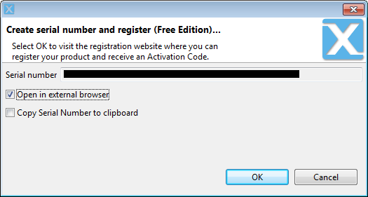

  10. A new window will come up with your serial number as shown below. Select "Open in external browser" to open up a browser window to generate the activation key.10.png

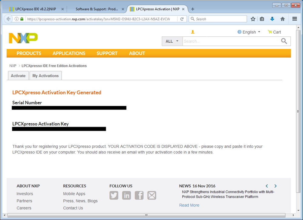

  11. Once the new browser window loads you will be presented with your activation key listed below the serial number. Highlight and copy this key.11.png

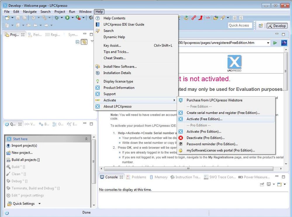

  12. We are going to follow a similar process to what we used to request the activation key but instead we will select "Activate (Free Edition)"12.jpg
