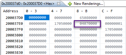

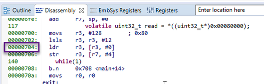

An example on S32K116:
Read an unimplemented memory (0x80000):
volatile uint32_t read = *((uint32_t*)0x00080000);
void HardFault_Handler(void){
  while(1){
Read the stack from the fault handler
In memory view, SP + 0x18
Find the instruction:
在原帖中查看解决方案

7,536 次查看
danielmartynek
Hi @Dinesh_Guleria,
There is a lot of useful information in the thread, please read it again.
  while(1){
7,467 次查看
Dinesh_Guleria
@danielmartynek
Thanks for your reply, it is clear to me.
Where exactly this figure comes from :--
In memory view, SP + 0x18.
Please suggest.
Dinesh
7,458 次查看
danielmartynek
Hello @Dinesh_Guleria,
This is a speudo code from ARM®v6-M Architecture Reference Manual
