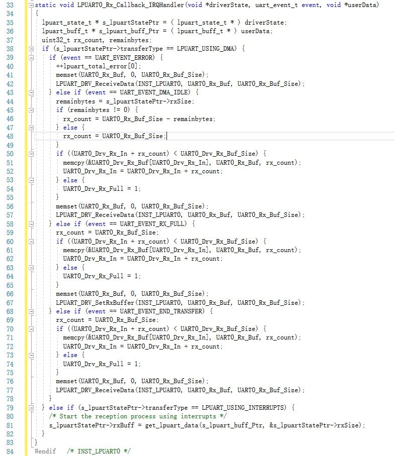

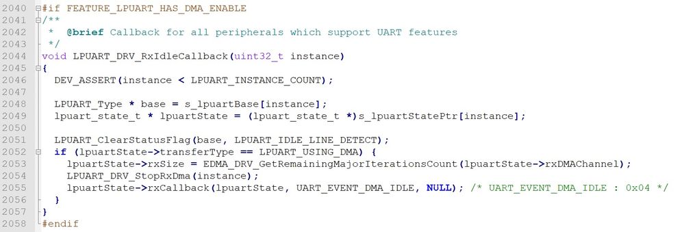

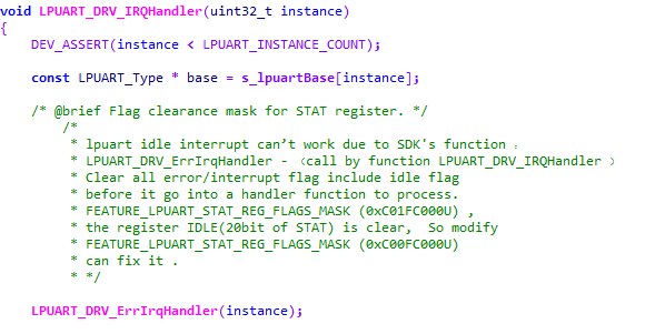

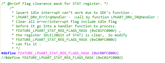

Hi there , I using LPUART with IDLE interrupt and DMA recv&send recently ,  here is my solution .
If you using the SDK LPUART driver , when enter the LPUART_DRV_IRQHandler() , all ERROR status are clear by LPUART_DRV_ErrIrqHandler() .
In the LPUART_DRV_ErrIrqHandler() , the IDLE status is also clear in the end .
      So modify the FEATURE_LPUART_STAT_REG_FLAGS_MASK ( in file S32K144_features.h )  , from ( 0xC01FC000U ) to ( 0xC00FC000U ) , to avoid the idle flag being clear in LPUART_DRV_ErrIrqHandler() .
17,453 Views

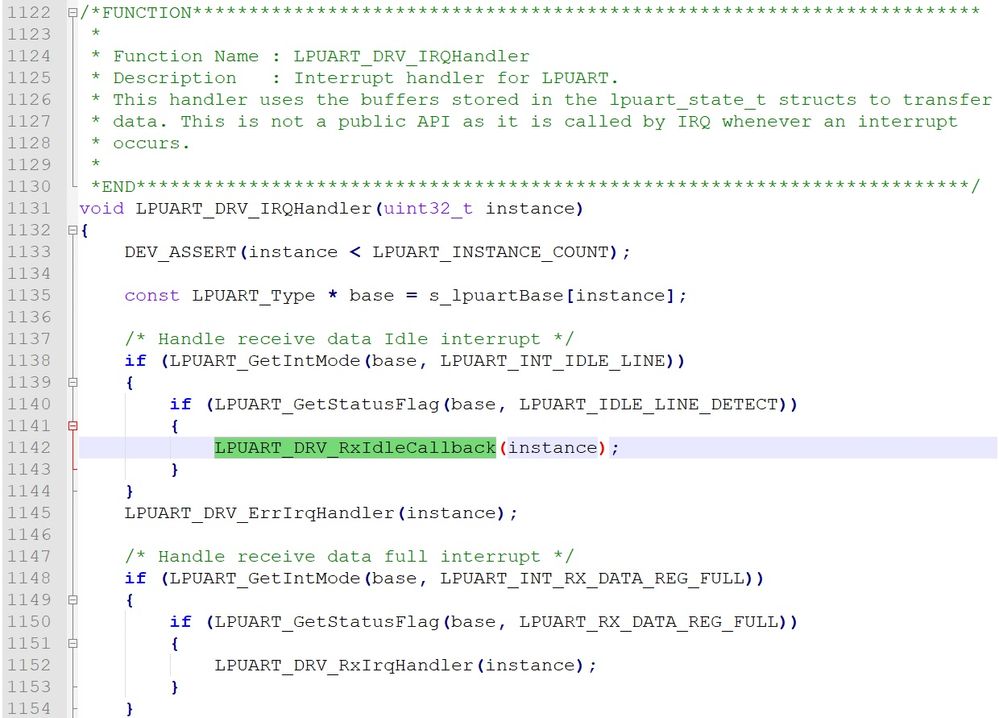

wjandsq
LPUART_IdleLineIrqHandler(instance)   must  be  first  lines  in LPUART_DRV_IRQHandler()   !
