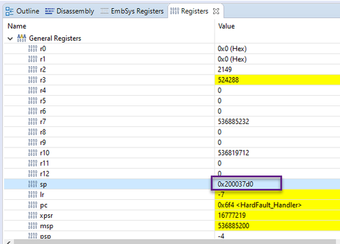

Hi NXP Application team,
Do we have some sample code where s32k116 hardfault handler is implemeted. So that we can trace from which instruction this hardfault occurred ?
Can i use same process as mentioned in this link :--
https://mcuoneclipse.com/2012/11/24/debugging-hard-faults-on-arm-cortex-m/
Please suggest.

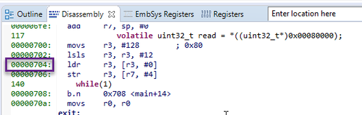

Hi @Dinesh_Guleria,
There is a lot of useful information in the thread, please read it again.
An example on S32K116:
Read an unimplemented memory (0x80000):
volatile uint32_t read = *((uint32_t*)0x00080000);
void HardFault_Handler(void){
  while(1){
Read the stack from the fault handler
In memory view, SP + 0x18
Find the instruction:

Hi @Dinesh_Guleria,
  while(1){

Dinesh_Guleria
@danielmartynek
Thanks for your reply, it is clear to me.
Where exactly this figure comes from :--
In memory view, SP + 0x18.
Please suggest.
Dinesh
7,532件の閲覧回数
danielmartynek
Hello @Dinesh_Guleria,
This is a speudo code from ARM®v6-M Architecture Reference Manual
