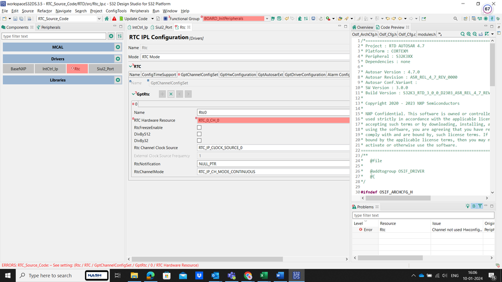

Hi Team,
I added the RTC driver for s32k344 but encountered some errors. Can you help me resolve them?

Hi @janakiraman-NTL,

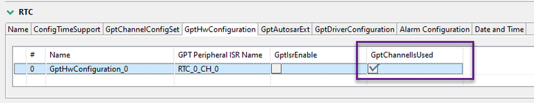

The channel must be selected in GptHwConfiguration
BR, Daniel

janakiraman-NTL
Hi Danial,
"Thank you for the reply.", The error was gone.
