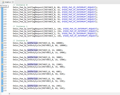

I'm using the API Emios_Pwm_Ip_SetPeriod for setting the period for instance 0 and 1 with the following configurations.
In autogenerated code it mentioned as Set period is only working in OPWFMB mode. For instance 0 OPWFMB mode is supporting, and it is working as per we expected.
But for instance 1, OPWFMB mode is not supporting, and we tried with the following configurations for instance 1.

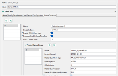

NITHYANANTHVS_3-1712656620395.pngNITHYANANTHVS_3-1712656620395.pngNITHYANANTHVS_4-1712656629229.pngNITHYANANTHVS_4-1712656629229.pngNITHYANANTHVS_5-1712656644335.pngNITHYANANTHVS_5-1712656644335.png
Using with this configuration, all EMIOS 1 instance channels are not working as expected.
Could you please give the guidance to resolve this.

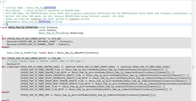

Emios_Pwm_Ip_SetPeriod->Set PWM using internal counter to a new period. Only DAOC and OPWFMB support.
Please call Emios_Mcl_Ip_SetCounterBusPeriod() for those PWM using master timer bus.

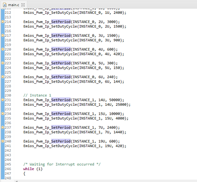

NITHYANANTHVS
Hi @Senlent
If I use this API  Emios_Mcl_Ip_SetCounterBusPeriod(), it will work for first pin only. If i configure more than one pin then the last pin only working remaining pin was not working as expected.

Isn't this the expected result? Because several of your channels use the same Counter bus.
