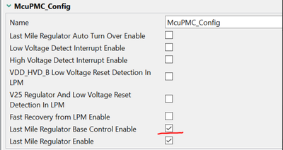

for "S32K344_GPIO_Wkup_S32DS_3_4_RTD_LLD_2_0"
1.I had to modify the PMC configuration to make this demo work properly.

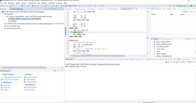

I have tested the S32K344_RTC_StandbyRAM_Wkup_S32DS_3_4_RTD_MCAL_2_0 and S32K344_FlexCAN_Wkup_S32DS_3_4_RTD_MCAL_2_0. I just modified the path to my local RTD2.0.0 path and built it successfully.But It didn't work. It crashed when run the mcu_init.
The project has no .s and .ld file, I think you are using the ones in the RTD drivers but you have modified it

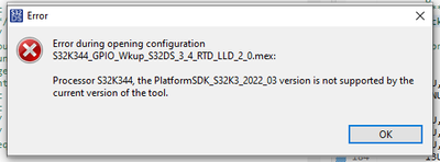

I have tried to run the AN in the current version 3.5 of S32DS with the latest updates, in order to test it on the S32K3X4EVB-Q172, but got this message:
is there an updated version?
Thank you for all but I have a big problem when I try to debug my projects. The problem is that when I debug the project, it should start uin the memory flash but the project starts in the sram and I don´t know what is the problem. Could you help me because I am very worried.

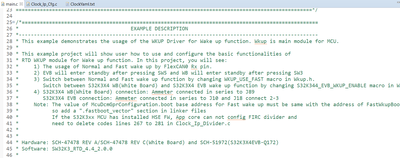

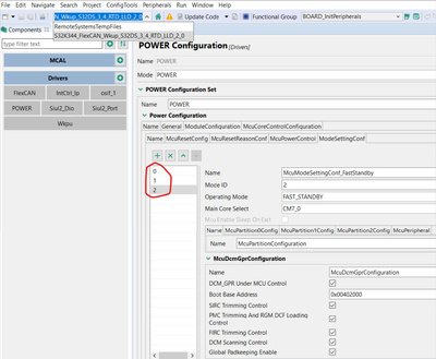

I’m having an issue with building this for the S32k322 can wake build. I’ve created a new project for the S32K322 based on the S32K344_FlexCAN_Wkup_S32DS_3_4_RTD_LLD_2_0 project.  The issue I am having is the clock table in clock_ip_config.c only : “const Clock_Ip_ClockConfigType Clock_Ip_aClockConfig[1U]” only contains one clock profile. The ClockYaml.txt only has one entry as well.
 The platform POWER driver is configured the same as the reference, but the two additional tables do not seem to exist.
Additionally, the Table for Fast Standby does not exist in the reference platform code even though it is configured in the POWER driver, there are only clock_Cfg_0  and clock_Cfg_1 in Clock_Ip_aClockConfig[2U] or ClockYaml.txt. If it is run as it is currently built with the s32k design studio it would crash in Wkup_EnterStandby().
How are these entries created? What step am I missing? The documentation for the example “S32K3xx Low Power Management.pdf” does not explain this.  Do I have to hand code this when it is defined in the "s32k driver GUI" for the POWER driver?
Hi Dtyree,
Please refer to the below method to add clock config.
Below is the example description and how to set up the example.
