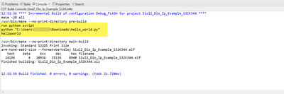

I did a simple test with a hello world and it printed before finishing building:
If this still does not work, try to add
cmd.exe
in front of your command line, so it launches the windows shell/command prompt.
