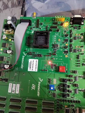

eleclin
Hello Martin
When I run debug using OSJTAG, it occured.How can I find the password?  Is it the same for all the MPC5775K?
When I use the default value,then pastedImage_1.png occured.  Dose "Power cycle the board" mean to off-on the power switch on the motherboard or press the reset botton on daughter card? I tried these ways but it took no effect. As a result,pastedImage_1.png
What should I do?
Hai
15,324件の閲覧回数
martin_kovar
please use DEAD_DEED_FADE_BADE instead of FEED_FACE_CAFE_BEEF and let me know, if it works.
By the way, power cycle the board means turn the power supply off and on (without any reset).
Martin

eleclin
Hello Martin
I have solved this problem. The cause is that there is a conflict between the debugger and the power supply. When I cut the power supply from debugger to EVB by off the jumper in my debugger. After this, I succeed in debug.
Hai
15,324件の閲覧回数
eleclin
Hello Martin
I have read the link: https://community.nxp.com/thread/382735
chip number is PPC5775KMMY3 2N76P CTEZR1622B
I tried both DEAD_DEED_FADE_BADE and FEED_FACE_CAFE_BEEF, it still appears.
Power cycle part:
I tried to turn the power supply off and on by POWER-SW (with DC supply) on the Motherboard, and it didn’t work.
There are something confusing.I only connect the JTAG debugger and it seems to power the board. Does it make the power cycle failed (when I use DC power supply on motherboard to doing the power cycle ) because it always power the board? Also, the red LED D9 is always on. Is there any problem with the board or debugger?
