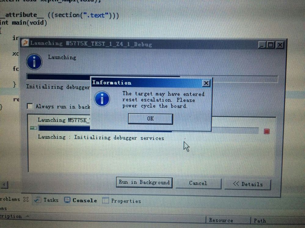

Hello everyone,
Does anyone try to debug MPC5775K(MPC5775K-356DS +MPC57xxMB ) with P&E Multilink FX(Rev.B) and S32DS for Power, I tried it, and got the following error with its default debug configuration:

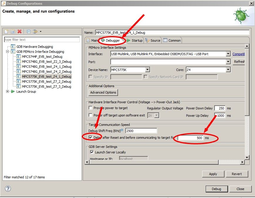

I tried to enbale and modify the delay after Reset and before communicating to target for 500ms, the reset issue solved, but it still cannot download the codes and hug at launching GDB server.
I have no idea how to fix the issue?  is there any other configuration should be modified for MPC5775K debug, or any patch for the issue?

stanish
Hi Enwei,
this will probably not resolve your issue but it's definitely related to this topic.
If you use MPC5775K Cut3 silicon (mask 1N76P) the "Password Required" dialog appears at the beginning of the debug session.
Of you click Ok or Cancel - you will not connect to the MCU. This happen because cut3 has a different default password.
You should enter 0xDEAD_DEED_FADE_BADE instead of 0xFEED_FACE_CAFE_BEEF.
Now the debug session should be successfully established.
Stan
