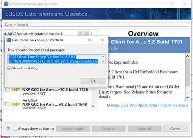

An error occurred when adding the S32K3 Real-Time Drivers Update Sites(SW32K3_RTD_4.4_2.0.3_DS_updatesite_D2302.zip) in S32 Design Studio(V3.5), as shown below:

Hi @Panpan
S32K3 RTD v.2.0.3 is delivered as an Update Site for S32 Design Studio "S32 Design Studio IDE v3.4 Update 3".
B.R.
VaneB

Panpan
Hi VaneB,
Might I ask a question?
How to install S32K3 Real-Time Drivers for S32 Design Studio IDE v3.5?
Best Regards.
5,642件の閲覧回数
VaneB
Hi @Panpan
I suggest you download the S32DS v.3.4. If you still want to use v.3.5, take a look at the below community posts:

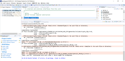

Hi @VaneB
Thank you for your help.
I have installed the S32DS v.3.4.
An error occurred when building the S32K344_HSE_OTA(SW32K3_OTADEMO_0.8.0) project, it seems to be missing the StandardTypes.h/S32K344_MU.h/Compiler.h etc. file, where can I find these file? or do you know the solution?
Looking forward to your reply.
Best Regards.
5,610件の閲覧回数
VaneB
Hi @Panpan
For the S32K344_HSE_OTA project, you must have installed the Real Time Drivers v1.0.0 in S32DS v.3.4 and the S32K344 with AB_SWAP HSE firmware.
