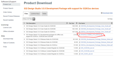

I am referring to the S32 Design Studio 3.5.0 Development Package with support for S32K3xx devices 
What you are locating is the 'S32 Design Studio 3.5 Update 2 package for offline use'.
Please ensure you are downloading and installing the correct package.
To locate the correct package:
1) Login to NXP.com
2) Proceed until you reach 'Product List' page:
3) Select 'Automotive SW - S32K3 Standard Software'
4) Select 'Automotive SW - S32K3 - S32 Design Studio'
5) Select 'S32 Design Studio 3.5.0 Development Package with support for S32K3xx devices '
6) Click 'SW32K3xx.S32DS_3.5.0_D2212.zip' to download the package
Hope that helps.
Mike
