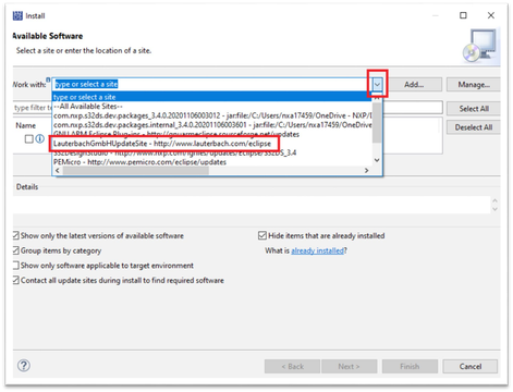

  • go to menu "Help" -> "Install New Software"
  • Click on the arrow to bring up the list.

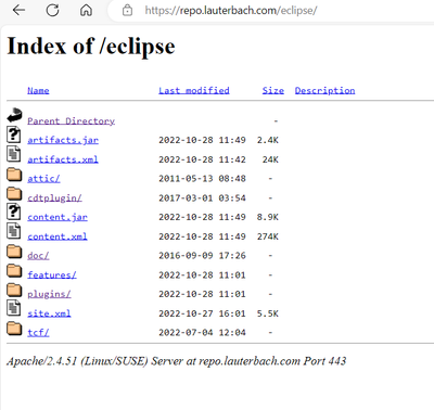

Select ‘LauterbachGmbHUpdateSite - http://www.lauterbach.com/eclipse

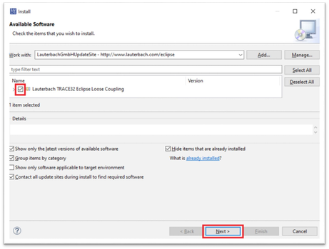

  • Check the box next to the Lauterbach TRACE32 Eclipse Loose Coupling and click "Next"
  • Check "I Accept the terms of the license agreement" and Select all Lauterbach certificates to trust.

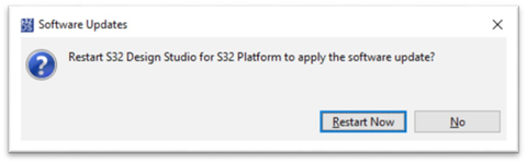

  • Finally you proceed to the installation. When the plugin is installed you will be asked to restart S32DS

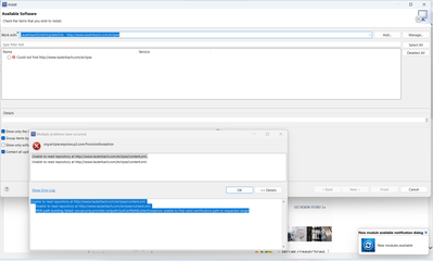

Unable to update the Plugins Could you help on this I can see manually page is redirecting to following page but its not considering the plugins
