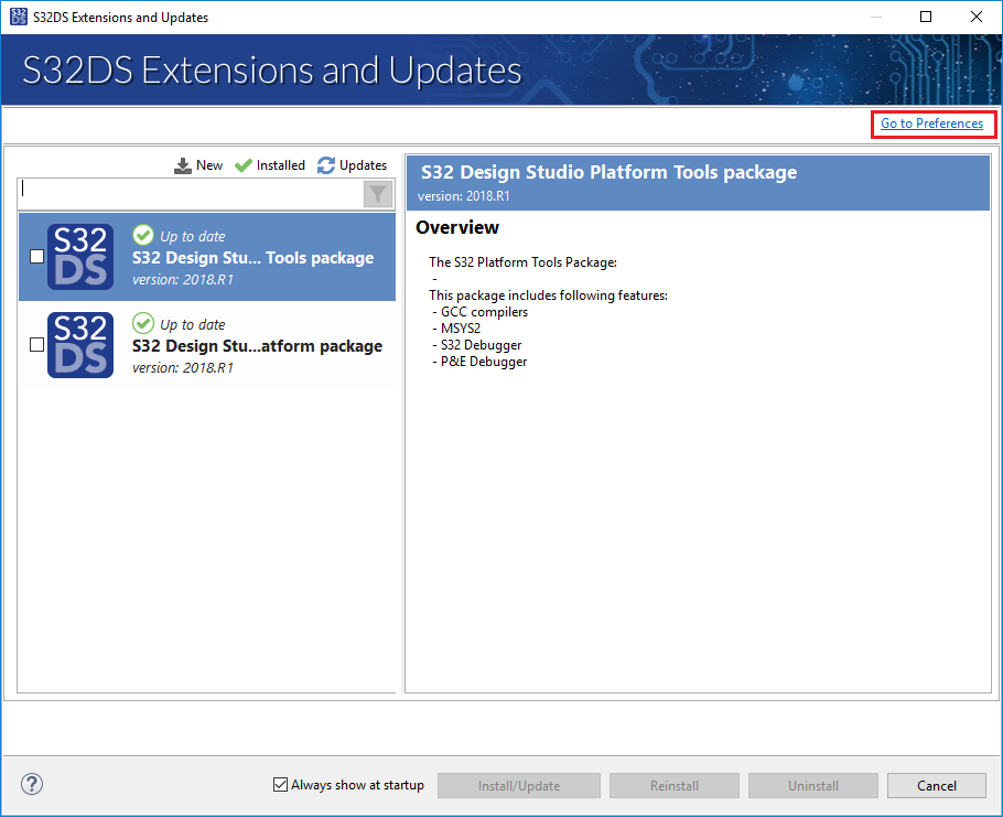

2) From S32 Design Studio, got to Help – S32DS Extensions and Updates.

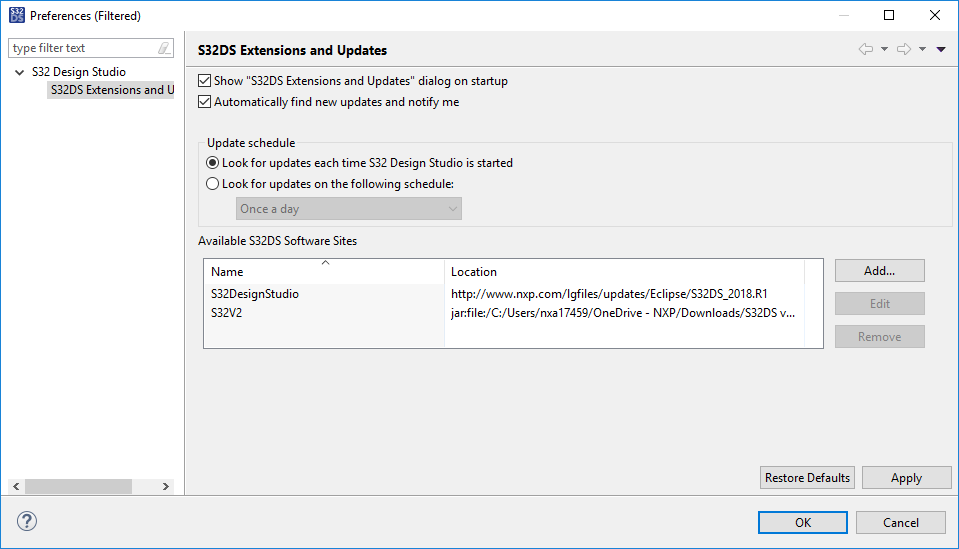

3) Click on ‘Manage Sites’ link.

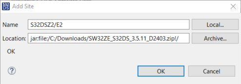

4) Select 'Add...'

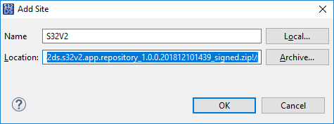

5) Select 'Archive...', locate the downloaded update:
6) Click OK.
7) Click Apply and Close on the Preferences menu

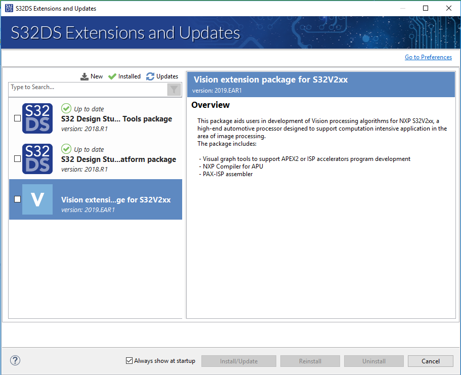

Notice the S32DS Extensions and Updates menu displays the new content.
9) Check the box next to the new package and click Install/Update.

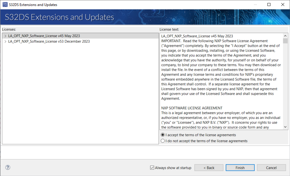

10) Accept license terms and click Finish.
11) After the installation is complete, restart S32 Design Studio.
