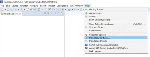

  • On S32DS graphical user interface, go to menu "Help" -> "Install New Software"

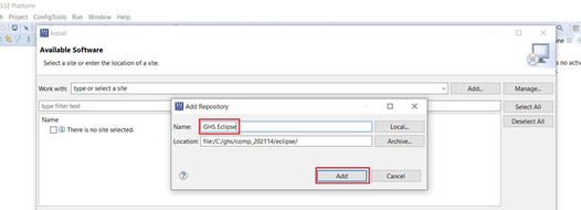

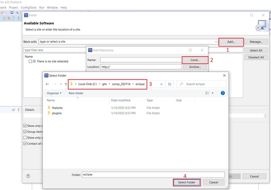

In the "Install" dialog appears, click on "Add" button. In the "Add Repository" dialogappears, click on "Local". Navigate to the eclipse directory located in your MULTI compiler installation(eg: C:\ghs\comp_202114\eclipse)
In the Name box, enter "GHS Eclipse". Click on "Add" button.

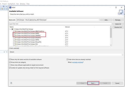

 In the Name/Version list, expand the Green Hills MULTI for Eclipse item. Select GreenHills MULTI for Eclipse corresponding to your target architecture(eg: Green Hills MULTI for Eclipse(ARM) and Green Hills MULTI for Eclipse(ARM64)). If you have MULTI licenses for more than one architecture, you can select all the targets you are licensed for. Click Next until you see the license acceptance page.
 If you accept the terms of the feature license, select I accept the terms in the license agreement. And click on "Finish" button.
If the Security Warning window appears, click on "Install anyway".
In the "Software Updates" dialog box appears, click on "Restart Now" to restart S32DS.- Go to "Window" -> select "Preference" -> "S32 Design Studio for S32 Platform" -> "S32DS Variables". Set your GHS installation path for S32DS_GHS_PATH variable (ex "C:\ghs\comp_202114").

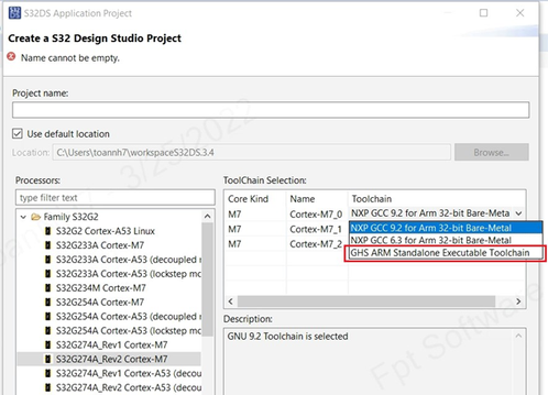

Create new S32DS project using GHS in the project wizard.
Now you can create a new S32DS project and select GHS toolchain for the device andSDKs support GHS toolchain.
And you can see the GHS settings are showed in the S32DS project properties.
