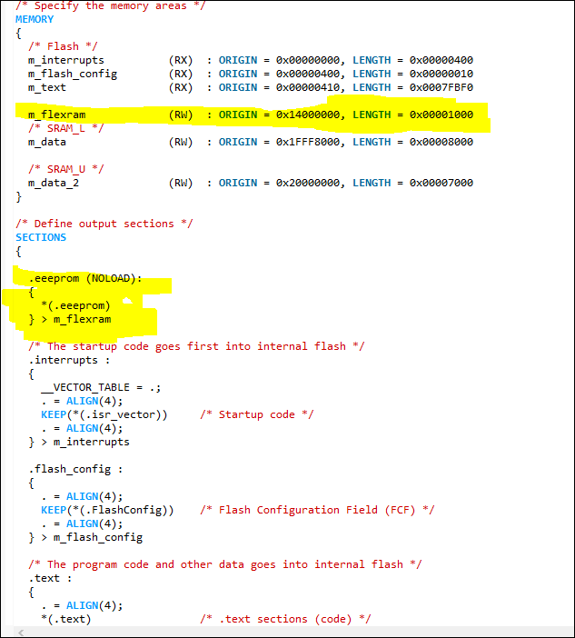

 Example shows how to configure PE Micro debugger to be able use FlexNVM as
 backup for EEEPROM - Emulated EEPROM  (Backup size 64kB, EEEPROM size 4kB) and preserve the backup
 memory. Configuration can be found in debugger Advanced Options.
 In the example is data structure located in FlexRAM section by linker file.
 FlexRAM data change cause flash store on background. Prior each data
 change you shall check if previous flash operation is done.
 In the example are two ways of FlexRAM (configured as an EEEPROM) usage:
  •  Direct access (up to 4 bytes can be stored once)
  •  IO Functions
 By direct access you can store only data up to 4 bytes. There is no way how
 to use memory move functions like memcpy/strcpy. In this case you need to
 use functions for store arrays or 4 bytes+ types like double.
 Part of example is LPIT timer storing runtime counter (seconds) each minute.
 PE Micro configuration:
 Enable partitioning for the device - code: 0x0204
 Preserve memory - range: 10000000-1000FFFF

0x020A is correct code - but the partitioning is write-once operation. If you use partitioning with PE Micro - you can't modify it in runtime, For me is your scenario working - I changed the example 0x0204 partitioning code to 0x020A:
Also make sure that DFLASH area in linker file (if you flash data into custom dflash section) doesn't exceed the 16kB size (0x10000000 to 0x10004000).
Jiri

I have followed the PE Configuration,
1.Flash Memory setting
2. Manually change .ld file
3. I have used the same  data structure located in FlexRAM section by linker file
4. Build success, but during debugging below errors are occurring, Please let me know what could be the problems?

you can use eeeprom_io_control from example. I tried remove all SDK stuff - and for me it is working. I tested in with non-SDK hello word example.
Basically - only what is mandatory prior EEERAM usage is DFLASH partitioning (via PE Micro for example)  - and preserve memory from 0x10000000-0x1000FFFF from being rewritten by PE Micro.
You can check EEERAM readiness in FTFC->FCNFG->EEERDY register bit. Should be set to 1.
I'm going to add non SDK EEERAM usage example into example list later today.
Jiri

Case1: PE Configuration is done and manually changed in S32K144_flash.ld file as mentioned above. (Is that must to di manual change in ..ld file?)

there is an example related to your question - https://community.nxp.com/docs/DOC-335619
Jiri
Dear Jiri,
So we can direct to use the FlexNVM as EEPROM. Then what is the advantage to configure FlexRAM as EERPOM then FlexNVM as backup (1:16)? This can achieve better w/e cycle endurance? performance is more faster? (Because in term of memory usage efficiency,  direct using FlexNVM without FlexRAM for EEPROM implementation is better?)
Thanks and best regards
He Wei
you have three options. Use FlexNVM (which is technically Flash ROM) as an Emuletad EEPROM. This requires FlexRAM configured as EEEPROM. In this case, you have 4kB of EEEPROM and FlexNVM (64kB) is used as a backup for EEEPROM. In this case you don't need care about flash algorithm - you can simply write your data into FlexRAM (EEEPROM) and all data are automatically stored into FlexNVM.
Second option is using FlexNVM as a regular Program/Data Flash. In this case - you need some flashing algorithm if you like store data in runtime. In this case - you can use full 64kB of FlexNVM.
Third option is mix of both - part of FlexNVM for EEEPROM backup, part as Program/Data flash.
Hope it helps.
Jiri
